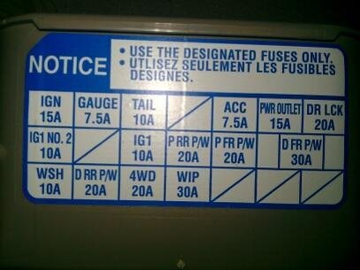

    I have a 2008 toyota tacoma. I was wiring my new halo lights when The wires from the DRL touched and i heard a small pop.
    I think I blew the fuse for them cause now they dont come on at all. Where is the DRL fuse located or what do I have to do to fix it?!?!?!

    Found out its the one indicated "tail". I had to pull up the wiring diagram at pep boys.

    Wow thanks for this post happened to me installing raptor lights and it blew the tail fuse

    Thanks for this post, blew my DRL fuse and head no idea which one it was. TAIL fuse in the dash was just the answer I needed. Thanks again!!

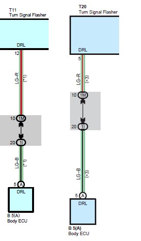

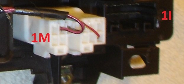

    I'm trying to remove my drls so they stay off I removed that fuse they still came on

    You need to cut a wire that provides the DRL feature to the flashing relay.
