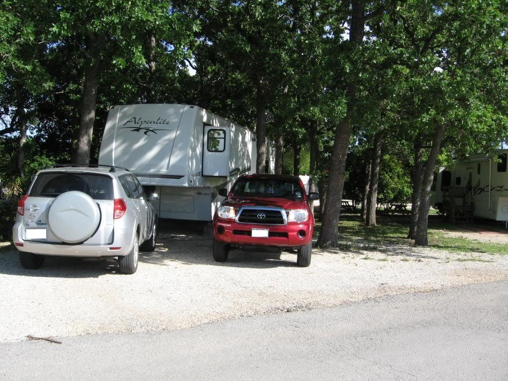

    I have a 2007, and when you turn on the "lights" you have two options: Parking Lights (outer small lights) and Headlights (very bright, can't miss :rolleyes:)...
    The DRLs on a 05+ are those large ORANGE lights on either side of the grill inside of the headlights. Those only come on when turn signal is on, hazards are on, remote unlock/lock occurs, and when you have the DRL module (or other modification).
    It should look like this when the DRL module is installed and the vehicle is running...
    I apologize for the crappy picture. I haven't had time to take a new one lately...
    However, I have finally uploaded all my pictures, and I am going to start working on getting my DIY article up today. I just hope that I have time... ;)
