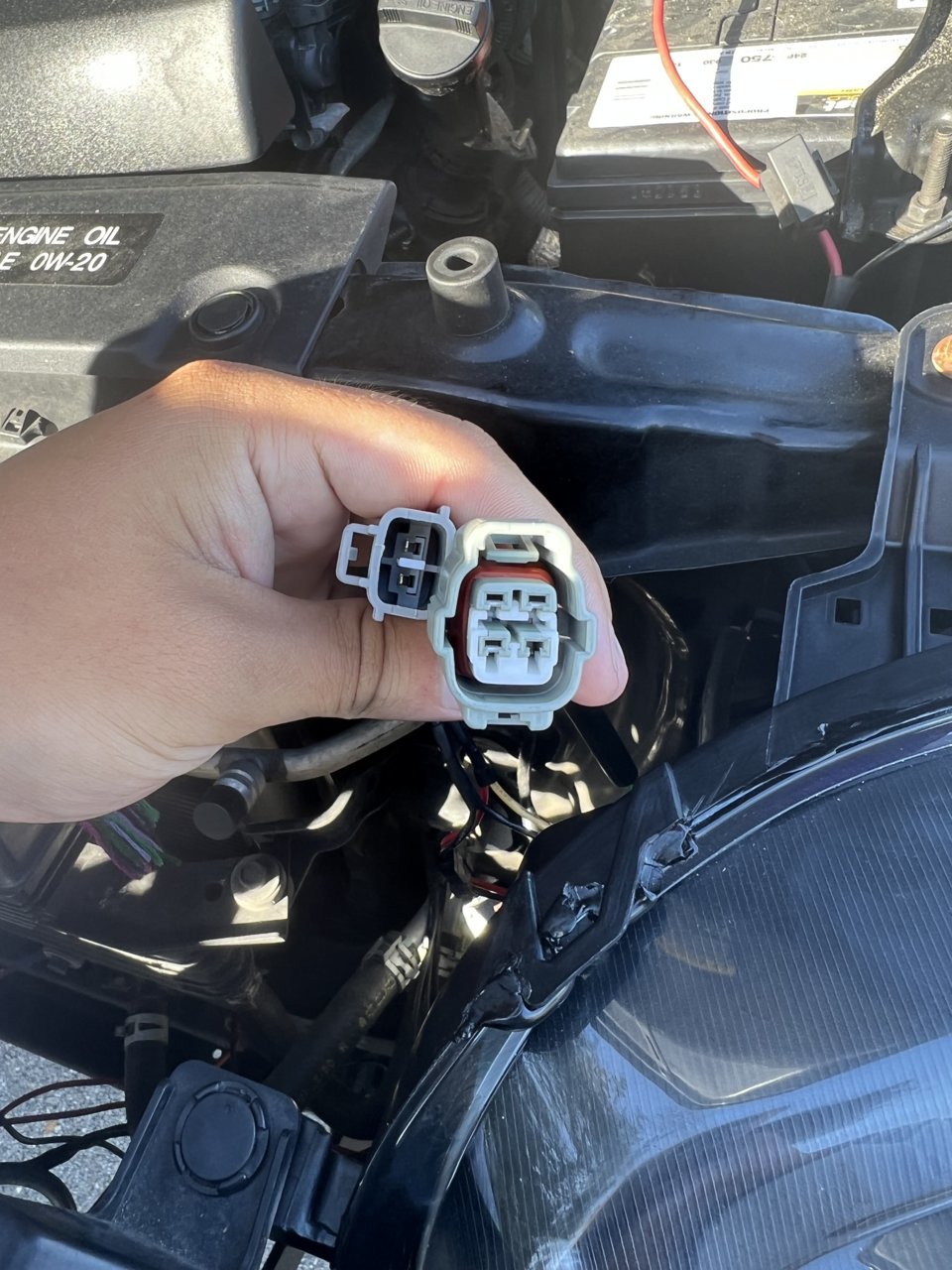

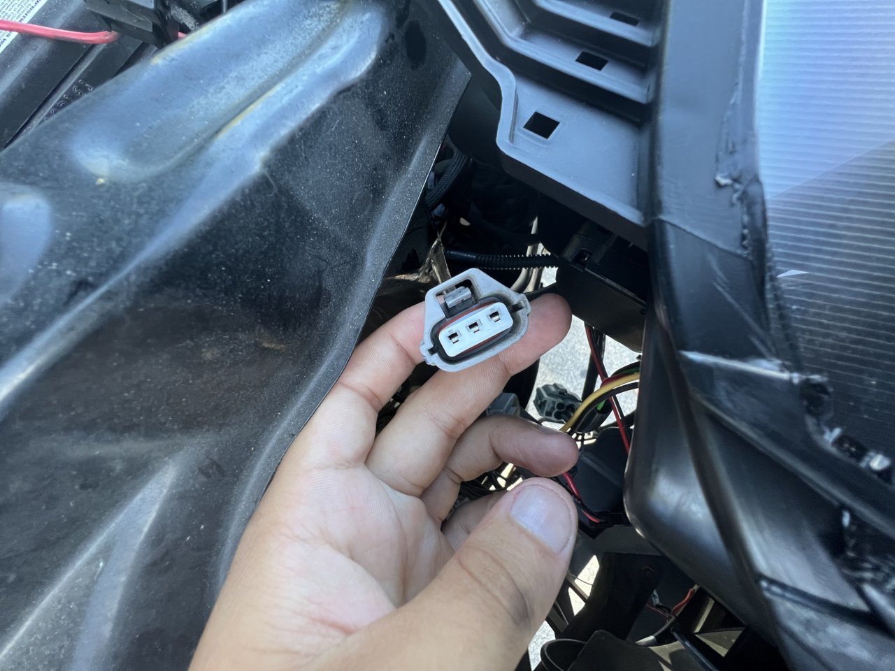

    @Puppypunter the second picture is the connection from my oem harness and the first picture is the drl connection from the new headlights

    Got your PM :) I think I am still the only one making them that retains the stalk functions. For the trucks that can doable the DRL, there are a couple options that don’t retain the full stalk functionality, but if you can’t disable the DRL, it limits what we can do

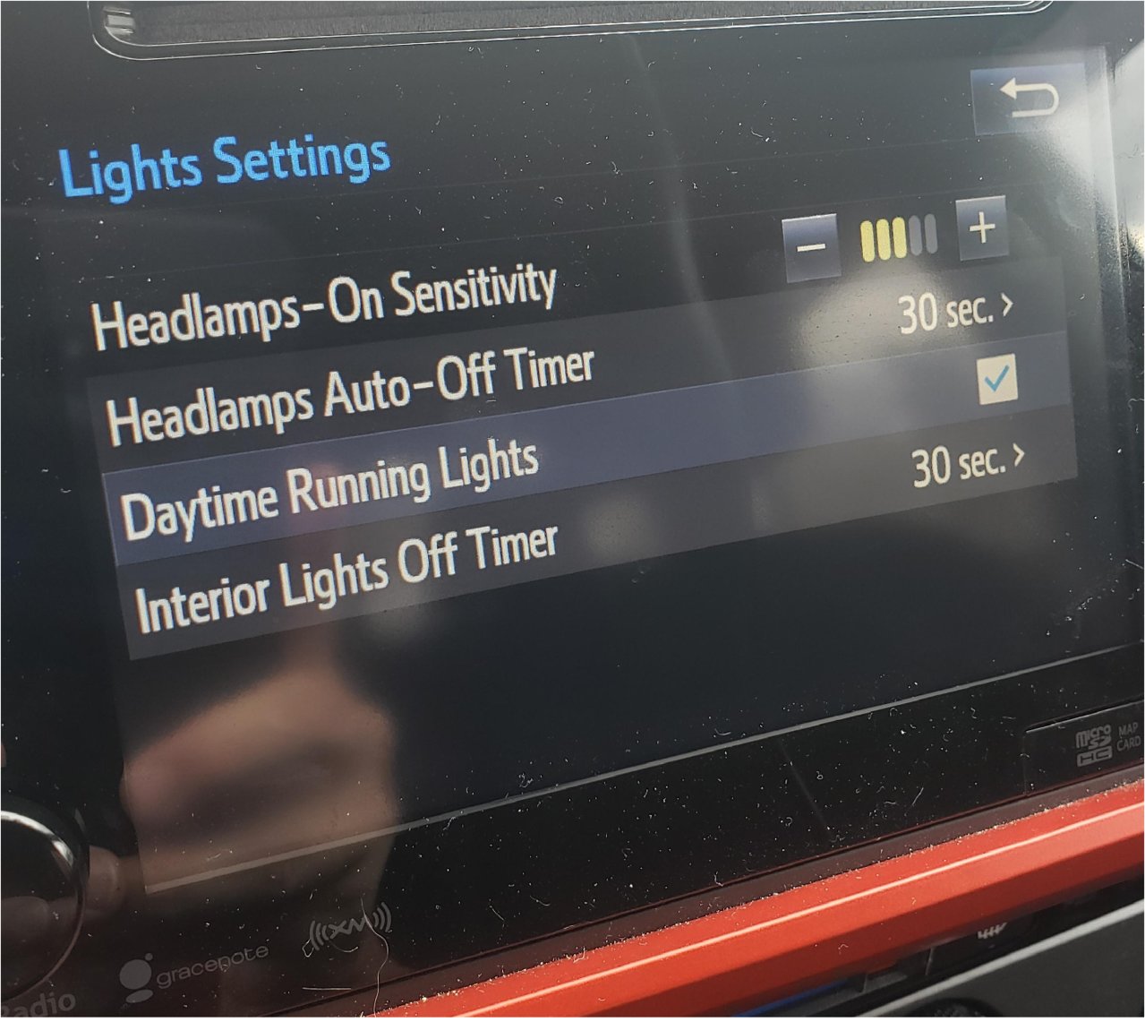

    @caribe makaira i dont have the stock head unit i got a new one but i dont have the led upgrade for the drls i can turn on or ofd

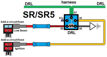

    So you'll need to add what I posted. And Puppypunter can sell you a harness to intercept the rear turn signals to substitute the front DRL/Turn ones.
