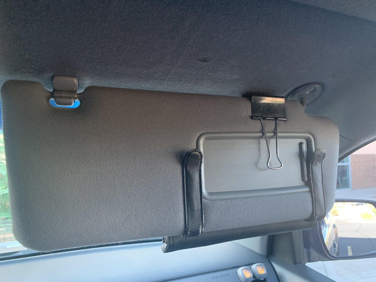

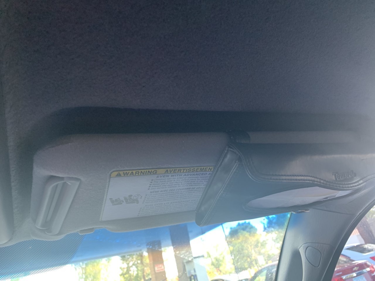

    Just ran out and took a couple pictures. Passenger side so clip is on the far right, closest to the door. With and without clip:
    ohcaltexscar and HandOfGod like this.
