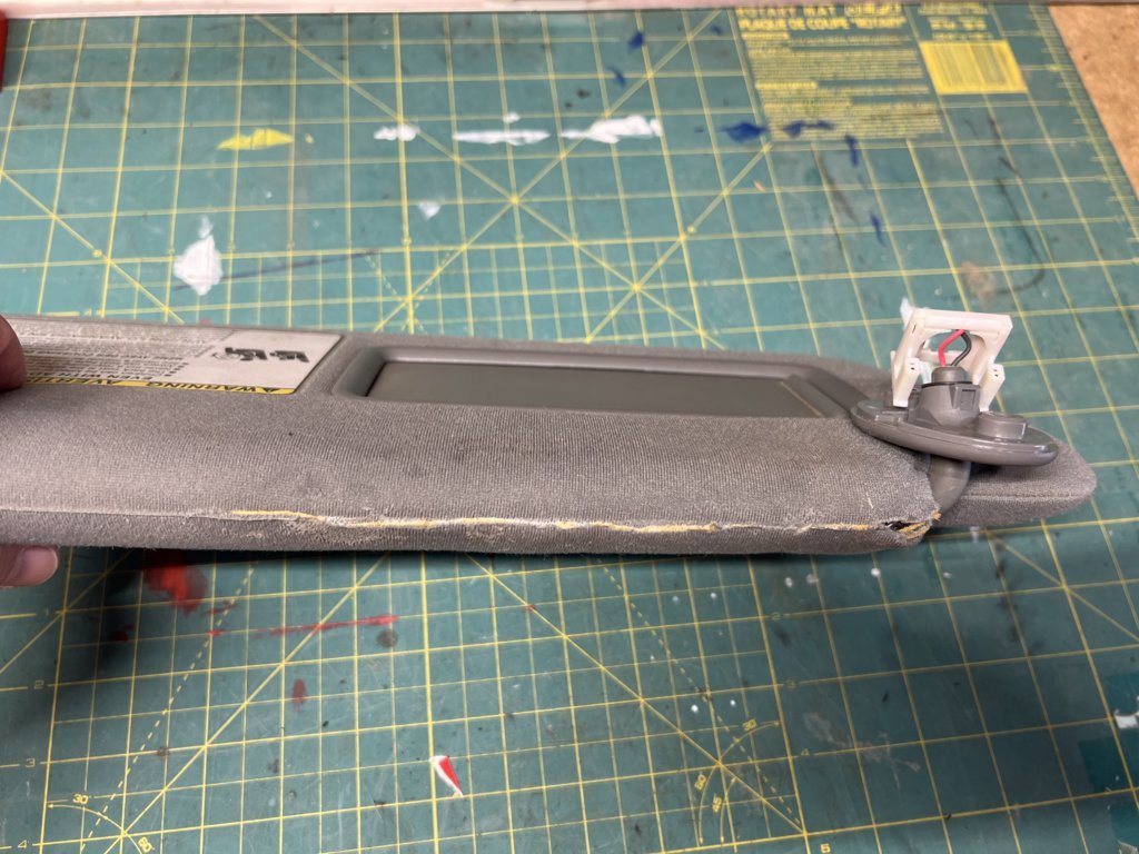

    I did this recently again to my passenger side visor. Cut it open, drilled a couple holes, used a nut a bolt, then tightened, sewed back up. Cost was just a couple bucks. Looks the same and works like new. I like keeping my vanity lights and didn't want to spend hundreds on a new pair only for this to probably happen again.

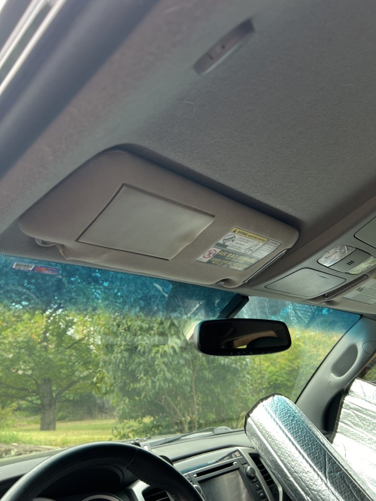

    This hack totally works. I used superglue to reattach the fabric. Hindsight, I coulda tightened the nut & bolt a bit more but it was difficult to move by hand on the table, didn’t want to overcook it. I have about a 1 finger gap between the visor and headliner but it’s firm, no floppy :jerkoff:
    Had trouble finding the notch in the metal clip because my visor didn’t have the dimples shown in others pics, maybe the po swapped it with aftermarket sometime in the past. Good to know it’s built the same if that’s the case. Anyone know how to tell if the visor is OEM or not? Both my visors are the same color and both swing to the side window without hitting the roof so IDK. No part # anywhere to be found.
    * id suggest do a test fit in the truck to confirm how tight to go with the bolt prior to reattaching the fabric.
