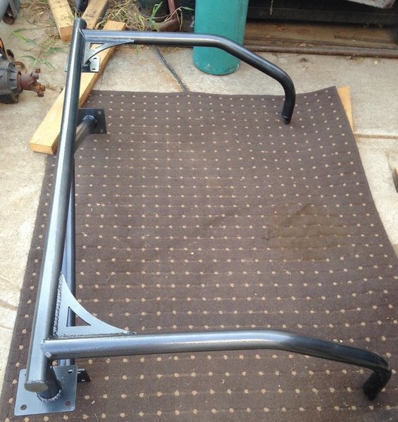

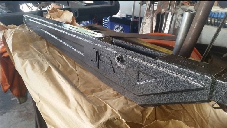

    Maybe just a week of work left...
    Got the links and bed cage back from powder coat yesterday, front end self aligned, CO's installed, front diff re filled and new hoses installed so the only thing left for the front end is to modify my resi's mounts to fit around the double shear gussets...bumps were delayed so those will go on next week-ish and straps at the same time.

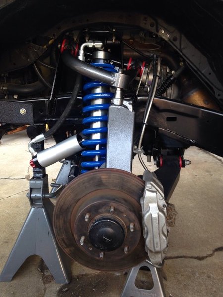

    Did you go with TC spindle gussets? Also, did you sell your Kings?
  12. Aug 20, 2015 at 2:12 PM
    #52
    Evenflow
    Evenflow Well-Known Member
    Jul 15, 2013
    #108344
    5,766
    Jason
    San Diego, CA
    06' DCSB 4x4
    Yes
    Yes, the TC sway bar version gusset since it has the extra gusset out to the tie rod end. No, I did not sell the King's I got really lucky because it turned out that the custom built ones I had for the DB were in fact an 8" body with 10" rods and raised coil seats. The only thing I had to do to turn them into a regular 8" travel CO was remove the 10" rod and install 8" rods...well..not me actually - DSM did it. The only part left to modify is the King resi mount, it hits the double shear gusset so I just have to cut them apart, shorten them and weld them back together and rattle can them.

    Got the shock towers welded on today, bed cage in place and the links mocked up with the CO's :

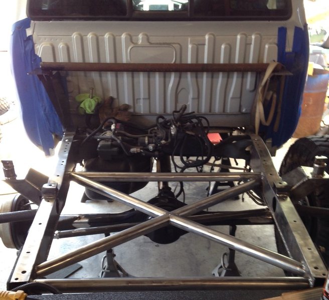

    frame plating and X member done...hopefully driving her by the weekend ( the rusty tube between the shock towers in just temp tacked to prevet warpage during final welding )
  18. Aug 23, 2015 at 12:54 PM
    #58
    2ndGenJonny
    2ndGenJonny [OP] Well-Known Member Vendor
    Jan 3, 2013
    #94306
    18,457
    Jon
    Gilbert, AZ
    What are you doing up front? Cross brace and plating?
  19. Aug 23, 2015 at 6:05 PM
    #59
    Evenflow
    Jul 15, 2013
    #108344
    5,766
    Jason
    San Diego, CA
    06' DCSB 4x4
    Yes
    We did Solo motor mount and double shear gussets, cam tabs & patched DB cross member cut. Have plans to do a tower cross brace pretty soon.
