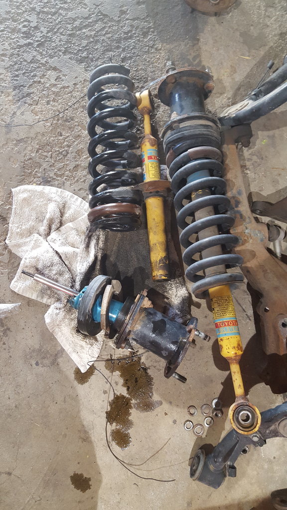

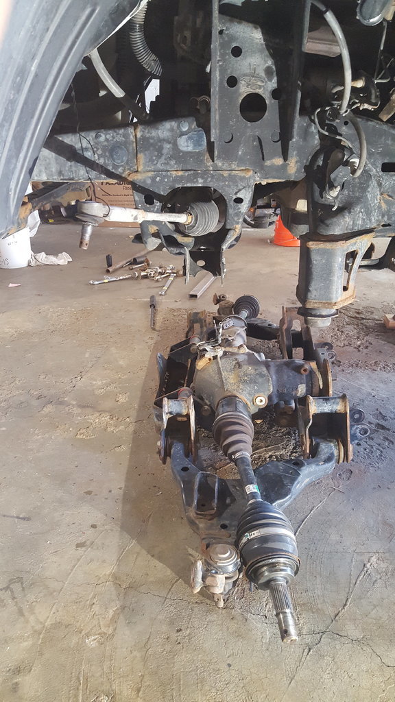

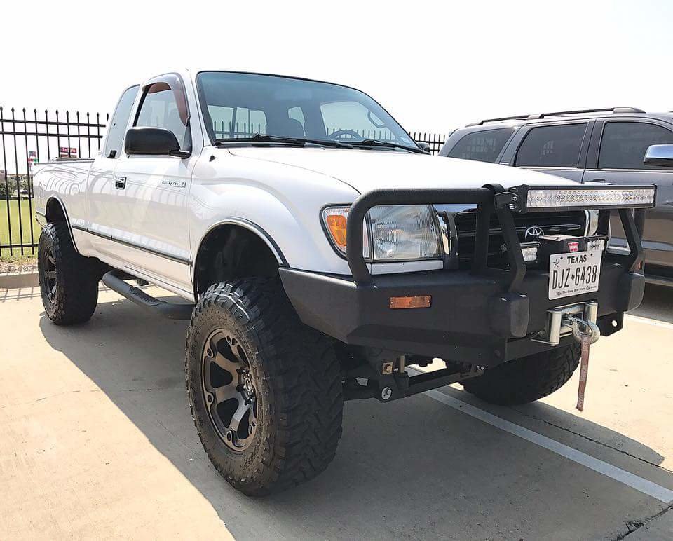

    Gathering parts now. Here's a few pics from a couple months back, that made me realize I need to go to stock ... ish stuff.
    Those that have gone back to stock, are there any misc. parts that you found you needed afterwards? Factory diff mount?
    Also, if anyone went to Bilsteins and coils, or coilovers, did you use a diff drop or install new uca's or anything?

    I had to source some things that seemed somewhat hard to find at least in my area. Mines a second gen so a couple things might not apply to your first gen truck. But hopefully this list gives you some ideas.
    - Stock diff mounts, and bolts for both the frame side and the diff side, if you plan to run a diff-drop that would work for the frame end.
    - My stock knuckles were replaced in the lift, had to find a set of those. Also welded gussets on before install.
    - Stock knuckle bolts for the LBJ bracket ( not applicable for 1st gens ).
    - Alignment cams were seized into the LCA for me, pounding and cutting ensued, I was able to save the control arms but I had to buy new cams for both sides
    - I replaced UCAs with aftermarket ones at the same time on my truck, but depending on how the DB lift spaces the knuckle down there could be some change here ( Kinda looks like a big spacer in your pics, so if you can separate the UBJ without ruining it then great, but it might not be a bad plan to replace while you're in there already)
    - Frame chunk for me, many others use rec tubing here
    - I completely re-did the rear, new springs, shocks, u bolt flip, bumps, etc.
    - 2nd gens use a carrier bearing drop, not sure about 1st gens, but there could be some kind of spacer in the driveshaft neighborhood to think about
    - And there were a ton of relocation tabs for brake lines and wiring. I removed them on my truck. That required some re-bending of hard brake lines, I may replace those lines just for peace of mind.
