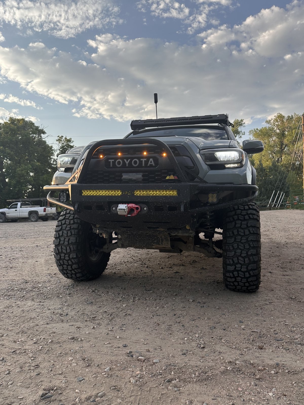

    Here is one thing that this thread overlooks. A Drob bracket lift allows clearance for larger tires which gives you more ground clearance. But what it also does is give you the same down travel that you had before. This it the main problem with ifs. When you lift a truck 3” you rob it of the down travel. You get about 1” afterwards. By dropping the lower control arms you get the body clearance, and conserve the down travel. A typical db lift is from 4-6” and the brackets drop the suspension 3” bolt to bolt. So the higher you go the less down travel. A 6” lift is the same as a 3” lift in flex. But a 4” db lift is the same as a 1” lift and gives you 4” of down travel and can clear 35’s as opposed to the stock 5” of down travel. Just food for thought and something I wish I knew before installing mine.

    That's a very good point that most people miss or fail to mention. You can recover an inch or so of downtravel with extended-travel shocks and UCAs, but that still means you lost two inches of it on a 3" lift. Go too high without DBs (over 3", or even over 2½"), and you're also inviting CV joint problems and accelerated wear on your steering rack (forget about the decline in ride quality).
    DB kits have their place... That downtravel along with the increased breakover clearance is very handy for rock (boulder) crawling. Where I would discourage a DB kit is on a go-fast build (prerunner, desert truck, etc.) where you typically are trying to balance a low CoG with having the most clearance under the axle. Long-travel is best here.
    It actually varies a bit...
    Some like Rough Country drop the mounts 3.25", others like BDS drop 4". There also may be other amounts, but ~4" seems to be pretty common.
