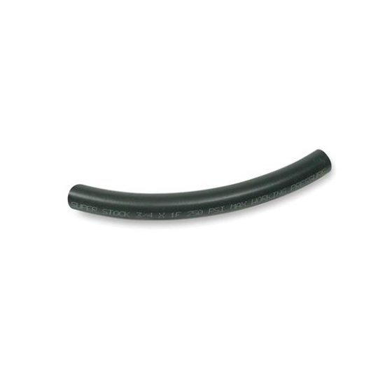

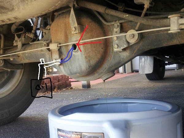

    Today for easter sunday being I had nothing to do I decided to change all the drivetrain fluids, starting with the rear diff using a hand pump and amsoil severe gear oil, I managed to pump 2 quarts inside my rear diff, after finishing the second quart and taking the pump off to start the next, the rubber hose on the pump somehow fell off into the rear diff. I spent a few hours trying to fish it out the fill plug, ended up draining it to see if it could come out but to my luck nothing ever did.
    So now I come to yall too see if you have any suggestions, should I run it and let it get chopped up and never have to worry about it, should I keep trying to fish it out(seems like finding a hay in a needle stack), or should I get someone to take it apart?
    Really lost and need some help here, its my daily driver and now i cant drive it at the moment, all help is appreciated thank you.
    It is a rubber hose, about 5 inches long and 3/8 diameter.

    If it's your daily and you can't afford to replace the diff on the off chance it causes a problem then I would make sure it gets removed even if it's unlikely to actually be an issue.
    There's not much room in the diff it's entirely possible it's hung up on something inside there.
    As for how to remove the diff it's really easy there's about 14 nuts on the face you pull those, pull the 4 bolts holding the rear drum backing plates in out and pull the rear axles out about 2" and then the diff pulls straight out.
    You will need a new diff seal and the special gear oil tolerant red FIPG that takes 24hrs to cure and burns your nose hair.
    Something to try, get a TIG welding rod sharpen one end to a needle point and give it a bit of a fish hook and try to spear the rubber hose instead of just trying to finagle it out, once you can see it in the hole grab it with pliers to pull it out.
    Also it may have reached the bottom of the diff you might try pulling the drain plug and or lifting the rear tires and turning them to get the ring gear to move and help the hose work its way to the bottom.
    Lastly having a locker you might try pulling the locker motor actuator but given the hose is on the opposite side and face it probably wouldn't help much.

    Since the drain plug is out....
    I would put the rear axle on jack stands and spin the wheels. Check with a flashlight to see if the hose becomes visible. Might be able to grab it with something through the drain or locker actuator hole.

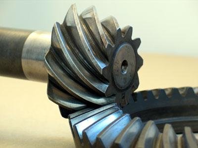

    Bearings don't love chopped up rubber....
    Gear sets have tolerances. Can you imagine what would happen if a rubber hose that will collapse a little went through this image? Wonder what that might do to the pinion bearing, journal bearings, or the housing itself?
    I have had to weld a Dynatrac ProRock 60 housing that cracked due to debris running through the gear set. This also included a new ring and pinion, master install kit, the purchase of an axle alignment bar to ensure the housing was true during welding (pre/post weld heat treat as well). That was an expensive fix...but could have been worse.

    Gear to gear tolerances are extremely fine, and yes the gears are hard hardened but this makes them brittle. Try and shove a hose especially one that may be reinforced with a fiber mesh like a radiator or transmission cooler hose in a space only a thousandths thick and something could break as it may put too much load in a direction the teeth weren't designed to take load in. Likely? Probably not, the hose would probably get shredded and smooshed and pushed out in the spaces if it even got into the meshing to begin with but in this instance probably not worth the risk.

    You'll kill the bearings. The gears have plenty of torque to suck in a chunk of rubber but the bearings can't handle the hundreds of tons it would take to squish it into zero thickness. The result is the bearings move at least a little and indent the races, and then you have bearings that will fail rapidly due to poor tolerances. Not to mention that once rubber bits get in the bearings they can bind just enough on the unloaded side of the bearing that the balls slide instead of roll, accelerating wear.
    I would not drive this truck as is. Especially since rubber chunks won't sink like metal chunks.

    UPDATE: so luckily my dad had the great idea of shooting compressed air inside and using a mirror under the drain plug to see it and after spraying and praying, we could finally see the tube through the hole, using a wire with a hook at the end were able to move it around till the tip of the hose was facing the hole and there was a good angle to get a small vice grip to yank it out(this took a lot of tries since the tube was so oily it would slip out of the needle nose pliers, after a bunch of tries, finally got it out, filled it back with oil now im good to go, but what a pain in the ass i hope this never happens to anyone else.
