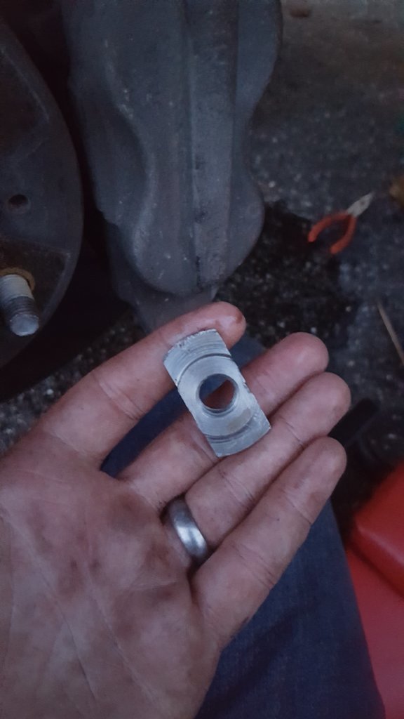

    Had the back of the needle bearing blocked but couldn't get the tool to sit behind the bushing. Tried removing it and lo and behold my magnet tool broke off with the nut of the ecgs removal tool falling into the diff. I managed to fish to magnet back but now I'm stuck wondering how to get this piece out without removing the whole differential. Help!

    Only suggestion I have is to try to fish it out with a magnet on a flex cable. Otherwise, you have to open 'er up.

    Not fun and not easy but you're gonna have to drop the diff and open it up.
    I feared this when I did my bushing too

    Well, this blows. Going out to buy a flexible magnet but I don't think the gap is large enough to allow it through

    if you have strong magnet, maybe walk the piece up from the outside, then grab with arm or flex magnet. You know, like playing with magnets where you have magnet under the table to make things on top of the table move around.
    Don't know of there are any internal lips that would block you from dragging it up.

    I'll give it a go. It's such a narrow space that I'm probably blocking the progress of the magnet as I reach back there

    I just rotated the shaft and eventually heard a clink. Popped drain plug out and after much frustration got it to turn and barely squeeze out
