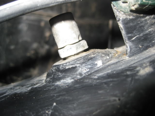

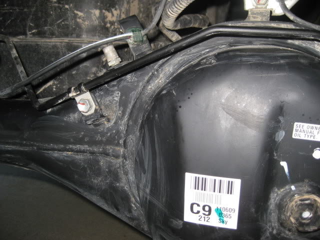

  10. Sep 12, 2014 at 10:11 PM

    I don't know what is inside if it. I have never taken mine off.
    I have not extended or relocated my breather either. I don't worry about it too much. I know many people that regularly launch boats and they never have issues.
    Now, I know there will be some that come along and say my advice is wrong.
    And that you need to relocate the breather if you submerge the axle in water
    regularly. But then again you should change your diff fluids more often too if you do this.
    50/50.... And I'm lazy and cheap. Plus I don't go swimming a lot.
