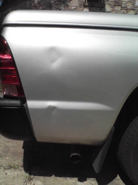

    i tried it out today. did it work? you judge for yourself.
    one day while working this is what i came out to in the parking lot:

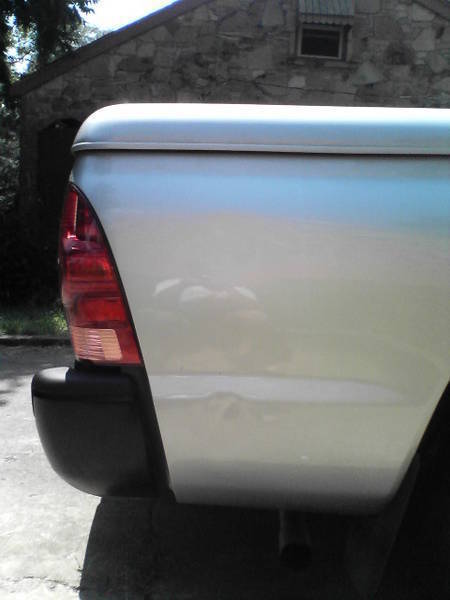

    needless to say i was not happy as my truck was less than 3 months old. so after some choice words and vowing to find the culprit i broke out the trusty dent puller. results below:

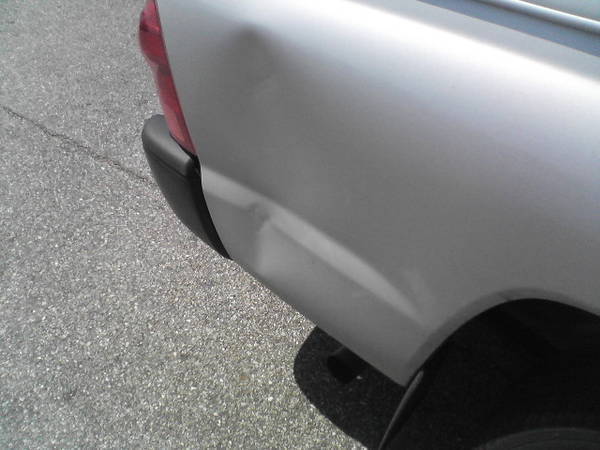

    not quite there but bearable. then i watched the video posted by johnny_jard. looks simple enough dry ice and a warm day easy to do in memphis, tn in august.
    i found out that heating the metal first with a hair dryer for about 2-3 mins then applying the dry ice worked the fastest and easiest. you can actually hear the metal coming back to shape after about 10 seconds

    the dry ice method works when the metal is not deformed. Small sharp dings deform the metal. Large dents don't really deform it, they just reposition it.

    i had some light creases in the metal in the 2nd photo it took awhile on that upper one.
    did you try warming the metal with a hair dryer or a heat gun then applying the dry ice? what also worked for me best is when the dry ice piece is applied to the center of the ding. you may have to do it the same spot several times i found. i hope that helps
