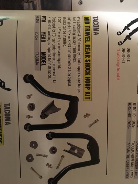

    Yes they already have it out just don't have it on their website yet

    Is their any info out on it ?

    This is all I got, comes from their new catalog

    29
    Thanks .. wheel spacers required ..

    Total Chaos +2" Long Travel Kit; King/TC 2.5 LT C/O w/ 16"x600; TC/CVJ Extended Axles; TC Spindle Gussets; King 2.5 RR shocks; All-Pro Expendition Leaf Pack; Pelfreybilt Sliders; Anti-Dark LED Hood Light mod; LED map and dome light mod; Bed lights; TRD Cold Air Intake; KB Voodoo Tailgate cap system; HomerTaco Thin Lip "Raptor" grille; sPod SE System w/ LCD Touchscreen; Baja Design OnX6 40"; Baja Design S2; Rigid Industries LED Rock Lights; Front Runner Slimline II Roof Rack; A.R.E. Z Series Camper Shell Projector BHLM Headlights (with custom wiring); Method Racing NVs 17"x 8.5; and Nitto Terra Grappers 265/60/17
    Yep, but if you have a BAMF already no need to change

    Nice. I really want the TC SUA kit. But yea you can get the hoop and do a 10" travel shock.

    Considering that the TC shock hoops look to mount the shock more vertical than horizontal, you may not get a full 12 with the shock hoops. In order for mine to achieve the full 12, my BAMF brackets were installed as far in the upper corners of the bed as they would go. Just some food for thought if you are indecision in regards to either the TC or BAMF relocation route.
