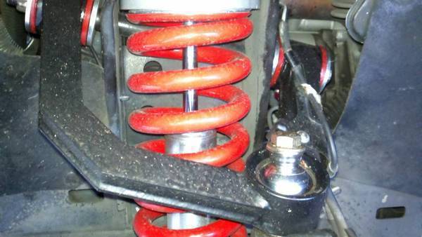

    So DownSouth Motorsports was nice enough to help me out with a build that I was doing so here is a review on their new UCA's.
    First off i have to say the quality is top notch, the welds and the fit and finish in perfect on these. Powder coating is perfect as well. The look of these UCA's is very cool in my opinion and is why i went with them. they are boxed and are made out of 4130 boxed chromoly with a a uni-ball and are tig welded. They also are greasable, and have built in caster for lifted trucks.
    I wont go much into instalation because they all install exactly the same. So if you have done them before it takes about 1.5 to 2 hours if you dont run into any hikups.
    Personally i have been very happy with the DSM UCA's. I have installed other brands on trucks and some fit and finish is hit or miss. As well as other brands have hit the coilovers on other trucks I've done. My truck is aligned perfect now and there is no rubbing with 285/70/17 with a -12mm offset rim. I didn't have to cut the cab mounts either. Did minor trimming on the flares but had to do that with stock UCA's as well (more because I have larger flares on the truck).
    I do not work for Down South Motorsports, or have any affiliation with them. Just a happy customer who has a lot of experience with aftermarket accessories, and a few people have been asking me to post up pics and what i think compared to others out there. I am also not bad mouthing any other companies out there but bang for the buck I do think these are some of the best values out there right now. If you have any questions for me feel free to ask. Sorry for the bad pics and the dirty truck, its been a little rainy here in the PAC Northwest if you can believe that!
    [​IMG][​IMG][​IMG]

    the real test is how well they align
  5. Nov 9, 2010 at 8:19 AM
    jusmac
    jusmac [OP] Well-Known Member
    Mar 2, 2010
    #32419
    275
    2nd paragraph, truck is aligned perfect. But then agian it was with stock arms as well.

    1" balls? How much? Anybody take these off road yet? I'm in the market for a new set.
  8. Nov 9, 2010 at 9:16 AM
    jusmac
    Mar 2, 2010
    #32419
    275
    yup 1" uni-ball, just some minor in the snow offroad stuff nothing big yet. i think they retial for around 500

    do a favor bro, and run those things over a jagged, ditched, whooped, banged up road at a fast pace and tell me how they survive. Do we have any numbers on extra wheel travel? I'm torn between built right UCA's and these.
  10. Nov 9, 2010 at 9:48 AM
    Tacomanator
    Tacomanator Boiling denim and bangin whores
    Jul 25, 2010
    #40746
    4,614
    Clam Slammer
    Southern Cali
    King 2.5" extended travel coilovers with compression adjusters, Camburg UCA's, King 2.5" rear shocks, TRD 1st gen CAI.
    sounds like you need to be in the market for a LT kit, not uca's
    the purpose for uca's is to correct alignment, not blasting through whoops. you may gain a couple inches of travel, but nothing major...

    Yea I mean for those of us that had to get uca's for the alignment purpose since the stock's wern't really cuttin it.
  14. Nov 10, 2010 at 8:02 AM
    jusmac
    Mar 2, 2010
    #32419
    275
    ya dor sure, they do make these with built in caster so it lets them align up perfectly with lifted trucks.
