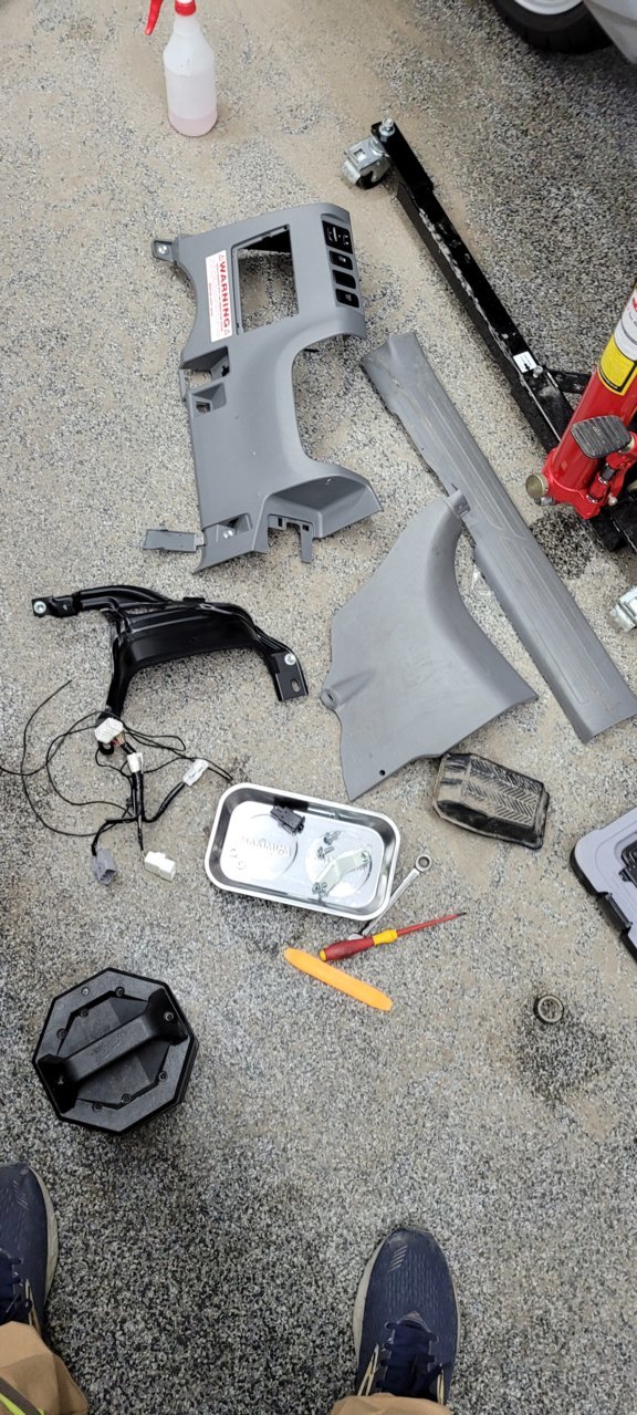

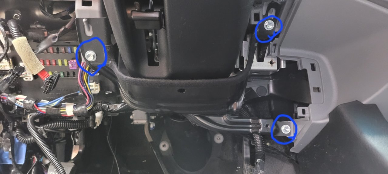

    I answered this myself, it does work on the 2015. I would highly recommend not trying to do this without disassembling the lower dash. I wasn't able to disconnect all 4 plugs to remove the harness without disassembling the lower dash. I probably wasted an hour. I have no idea why you'd want to struggle when it takes about 10 minutes to disassemble the lower dash and easily remove the fuse block. This way you can remove the harness and do a nice job with your splicing.
    Reference this for how to disassemble the dash:
    https://www.tacomaworld.com/threads/05-drl-daytime-running-lights-install-oem.1475/
    Super easy. The only thing I'd add, he only shows the two bolts to remove the lower dash. There are also clips on the left and right hand side. Pull straight back on each side and they will release.
    I also removed this bracket under the steering wheel. It gave me the clearance for the blinker unit to come out once I folded the fuse block down.

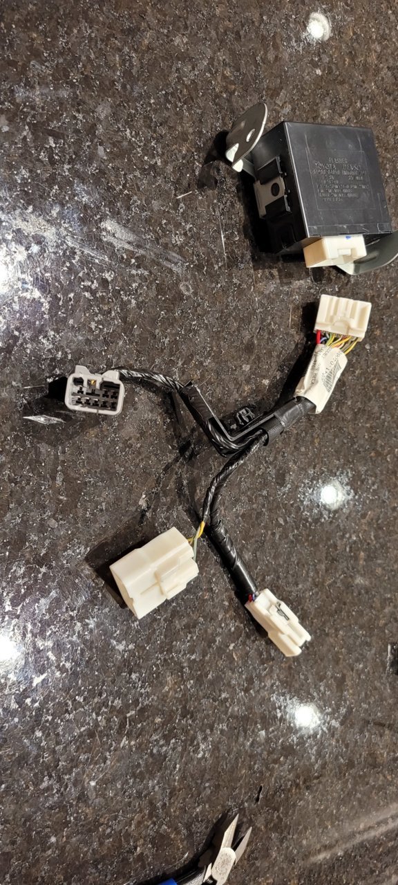

    Here's the harness you want:
    Disassembly:

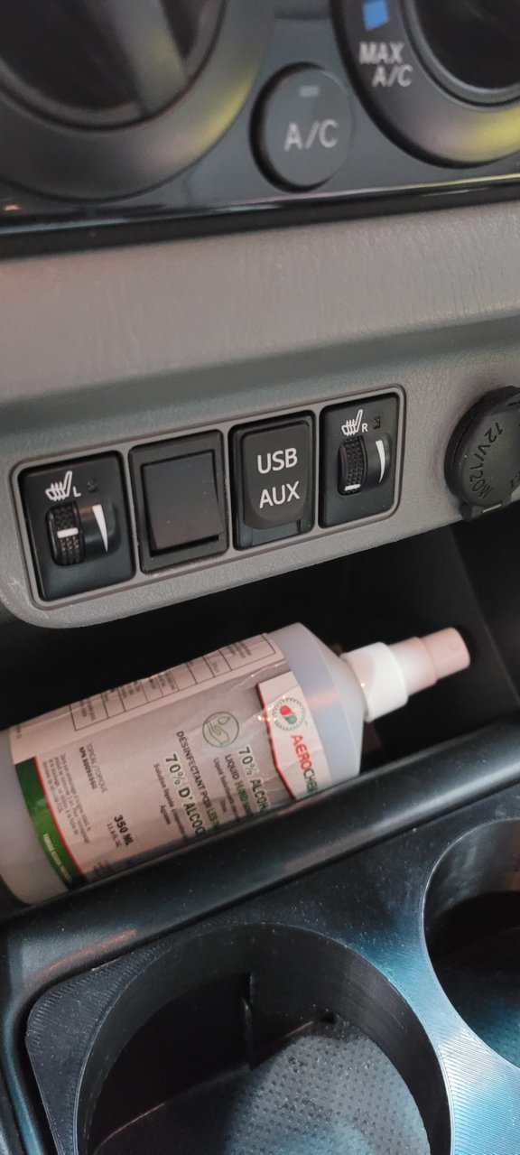

    It matches the cutout size almost perfect and the face of the switch is only 2mm wider and 1mm taller than stock, which would be almost unnoticeable. I used this site to source a switch for under the AC controls, it was a perfect fit. Here's how that one turned out:

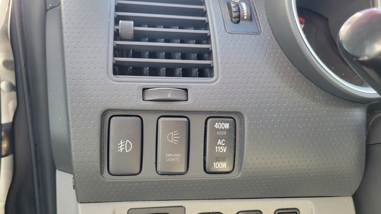

    I have two mictuning switches.
    https://mictuning.com/collections/toyota-push-switch
    I got one off Amazon and the other from them directly. Watch out, as they have two sizes. The smaller fit the spot under the radio and the larger fit on the dash. Per Amazon order history, I've been running them since 2016 or so. I also have it wired so that it dims with the rest of the dash. The "Driving Lights" is the DTRL switch.
