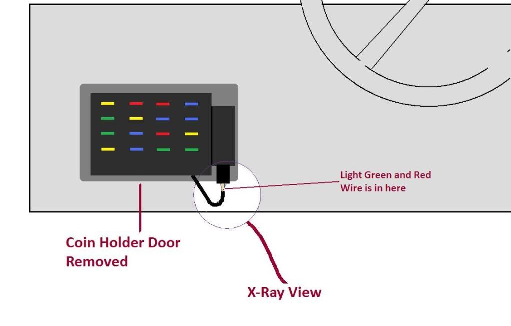

    I finally got around to doing this mod and I need help. I found agreen wire with red line, cut it and nothing changed at all. The pic shows the bundle I found the Green/red wire I cut and reattached with the orange twister. I could NOT figure out what this wire goes to. I have a '12 dc lb. Can anyone provide any help?

    so after cutting it your DTRL were still on? and your lights were switched off on the stalk?
    I did mine last summer I think, perhaps you got the wrong wire? Dunno exactly how many down there are that color pattern.
    Here are some previous pics to help illustrate the location of the proper wire.

    I disconnected mine from behind the fuse panel. If you lay on your back and look at the back of the fuse panel there is a white plug with 3 wires in it I pulled out the light green w/ red stripe.

    so i figured this smaller guage light green wire with thin red strip has to be it. Can anyone confirm before i cut it? Thanks

    Hey guys, I was successful in completing this mod on my '12 DC LB Sport Up. It was the light green wire with thin red line listed poste in the previous pic. I was able to solder my pieces cleanly, shrinkwrap and tidy up under the dash. Great mod, write up and input from all. THANK YOU!
