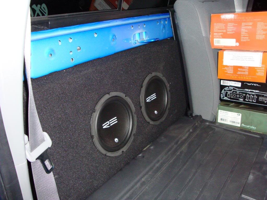

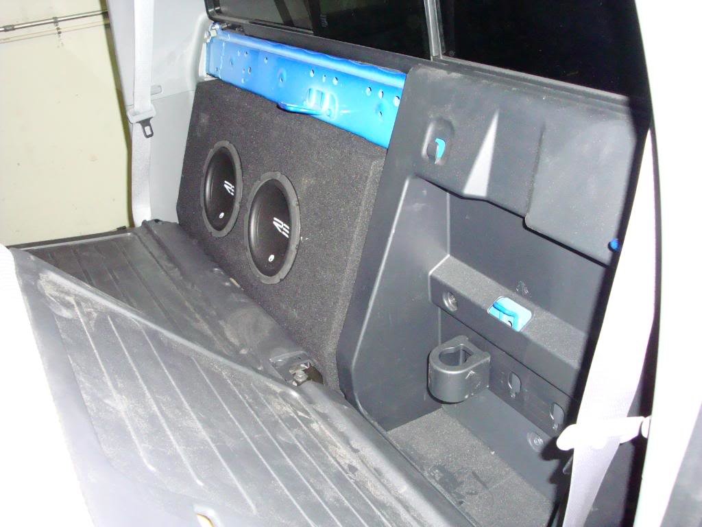

    Hey guys just wanted to share this enclosure that I've been bulding for customers here in Hawaii. This guys holds either 2 8 inch subs or one 10 ported with 1.25 cubic feet of air space. It fits perfect on the passenger side in place of the plastic storage compartment and you can still keep the drivers side plastic in place and it contours to match it. Don't mind the pics these are pics of the first one i did a few years back right after I finishes it and haven't taken any new ones since

    Nice with the side firing port. I bet it bangs. 4" port right? What's it tuned to?

    Thats a nice box! Looks like it fits really well. What is the max mounting depth? I'm interested...

    Yup 4 inch abs port. I was thinking abut using a 4 inch aero port flushing in the flange but I haven't tried one yet. As far as output it gets surprisingly loud for 2 8 inch woofers. So far the best combo I've used were JL 8W3's off a JL HD900/5. It was flexing the roof enough to make noise. The side fire port loads nice right there and it still gives enough clearance to let it breathe nicely. Tuning on that particular box was around 35 but I can go anywhere from 30 and up just depending on woofers. The other nice thing about it is the woofers load on the back of the seat which in turn gets a little more solid low end and better power handling.

    The max depth I an get out of it would be 5 inches maybe even up to 6 but I haven't tried going that crazy yet. If you are interested let me know what woofers you are thinking about running and I can probably get ahold of it and see how it fits or build it to fit the woofers.

    looks good! I always wanted some 8"s

    Looks good man. Congrats on the job well done. It has a nice clean look to it.

    nice build on that box. the RE 8" have an awesome sound for an 8. they had a couple of their 8" in a demo car at CES and it sounded like they had 2 15's, they seriously BANG.
