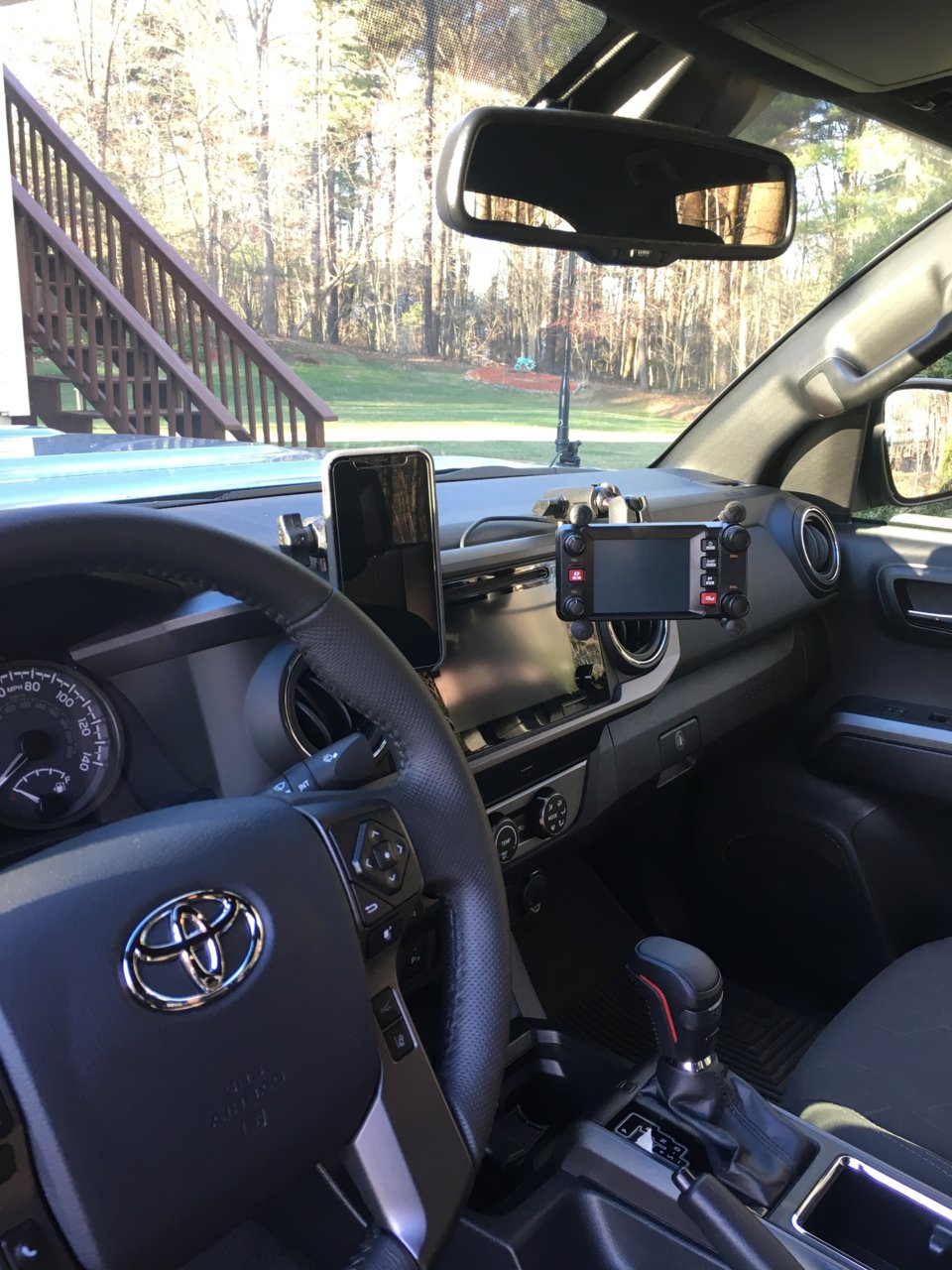

    I have a the Yaesu FTM 400 XDR and have it wired very similar to Mud 390's rig. Below is a pic of how I have the head unit mounted. I have the DMM kit and use a Ram mount to secure the head unit. Works well, no complaints.

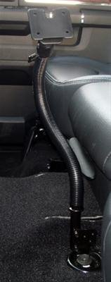

    I used a 18" RamMount Pod gooseneck;
    I shortened the rod to fit exactly where I wanted it level with the seat. It is very solid, does not move.
