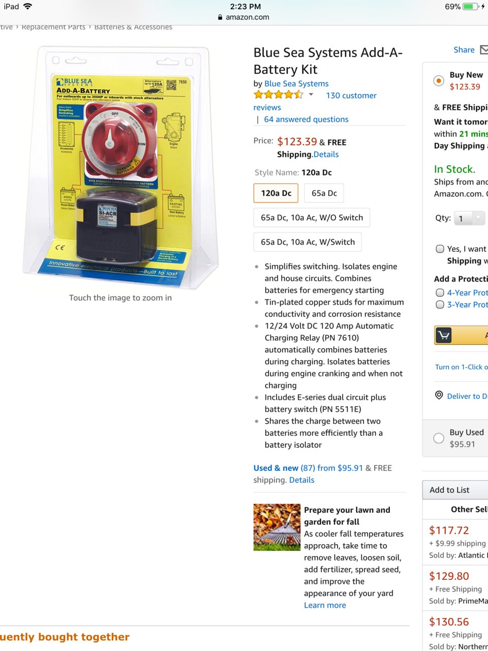

    Any of you electrical gurus help me out? I’m looking for a BASIC dual battery set up. I just want peace of mind when it’s 25 below in the winter.
    Could I use this.

    The biggest issue I see is that it's only 120A, could have trouble pulling enough amperage across in a jump start situation if one battery was dead or close to

    This works well. You will never see 120amps, unless something goes badly wrong, across the ACR. I have been using this for a while now.

    https://www.toyotaguru.us/engine-control-systems/current-draw-test.html
    Typical V6 175A
    There is lots of information available showing starters drawing well over 120A especially in the cold the draw can be much higher
    @-40 I would do some research of your own to check what starters draw before trusting 120A is enough to start your truck on a -25 day
    not trying to be a dick @Sandman614 I just would hate to see someone get stuck somewhere in that weather because of a burnt up battery disconnect
    OneFastGeek and -40 like this.

    If you want basic and cheaper, look into the Stinger unit that's been mentioned in this thread. You can find the link at the bottom of this page. $55 through Amazon, 200 amp

    The ACR isolates the starting battery from the aux battery. My statement stands, you will never see 120amps across the ACR, but let me revise that and say with high loads like a winch connected to the starting battery.

    I have a winch so does that matter?

    As long as it's connected to the starting battery, no. Generally an aux battery is used for lower draw accessories such as lights, and other 'house' type amenities.
