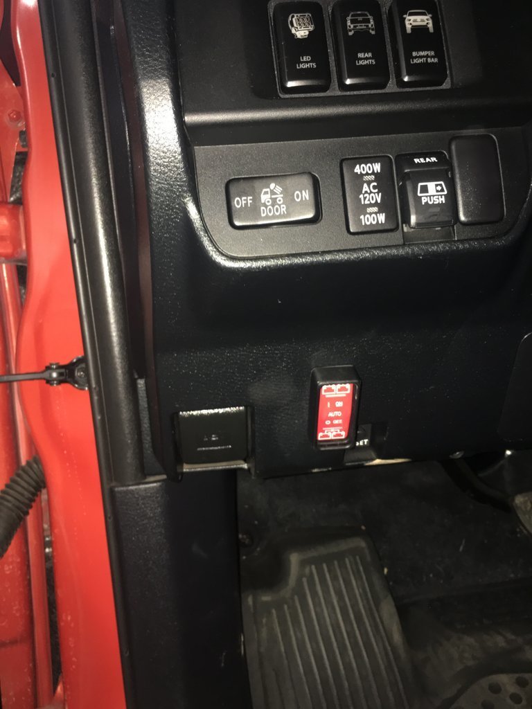

    Not my photo, this is from the OGE thread.
    I did not put mine where the switch is in the photo. I put mine in the blank switch spot to the right of the rear sliding window switch. Had to dremel out the back of the blank spot a bit. Looks OEM.

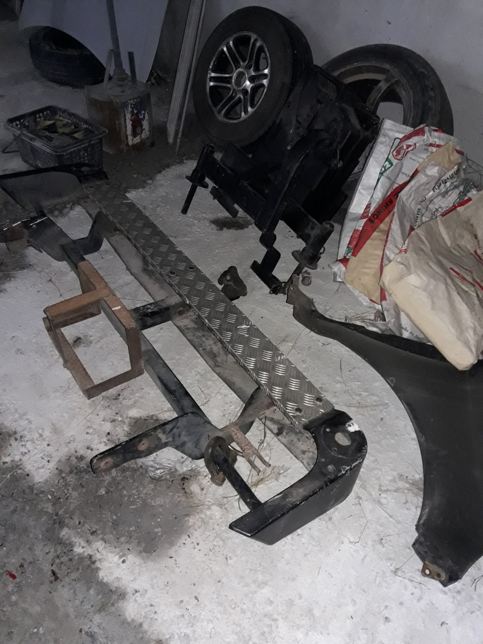

    I have no toom in my engine conpartment for a second battery. So this is the second battery tray attached to the rear bumper.. i bought the bumper yesterday its a dual swingout, today i sanded it and tomorrow paint, not bad for 210 dollars i think it is an arb but im not sure. I got the front bumper out of a pile of scrap for 300 dollars. ..here it is after sanding and painting.20181112_191335.jpg 20181112_164121.jpg

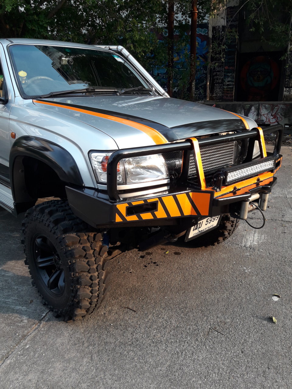

    whats the chrome pipe on the driver side?
    this is a sweet rig man
