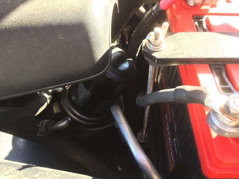

    Two group 25 or 35 with fit with the Off Grid tray, but it's snug to the oil filter and to an A/C line. It's workable, though. I still have the engine cover and that has to come off to change the filter easily.
    BTW, I've had the fasteners that hold the OGE tray to the factory bracket vibrate loose even with Nyloc nuts and blue Loctite. So this summer I'm probably replacing them with Nutserts or something similar just so it's easier to check them.

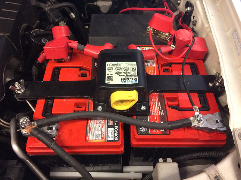

    Finally getting close to to wrapping this thing up! Been a bit more involved than I expected, but then again I tend to over-engineer stuff.. Final step is to extend the positive lead that feeds the starter motor so it will reach the new mil-spec terminal.
    Has anyone done this before? What gauge is the factory pos. cable from the battery to the starter motor? Some people say 2 gauge, others say 1/0 gauge. I'd like to get a short length of the correct gauge wire, and crimp the old and new together, and be done with it. Rather not re-run a whole new cable all the way down to the starter if I can avoid it.

    I ran new cables to the starter positive and to the block negative, I understand where you're coming from on being a PITA. But with the tire off it's not really too terrible.
    I used 2 AWG for both and I'd be surprised if the stock cables were even that big. Running a pair of 2 AWG EPDM welding cable was a tight fit in the cable tray that runs along the engine behind the coil spring tower. I had to leave the cover off and just zip tie the cables in place. Could be just thicker insulation than stock, though.
    Can't imagine they are anywhere close to 1/0 AWG. If I was guessing I'd have put the stock cables at around 4 AWG.

    Ok cool. So the pos. and neg. leads are the same gauge? I already cut the factory clamp off the neg lead and re-terminated that. It seemed to be about 2 gauge

    I'll have to pull out the old cables, I didn't cut the stock harness up in case I wanted to reuse it for something. I'm remembering an estimating based on a speculation of a guess. It *seemed* less substantial than the welding cable I used.

    That's about what I figured they were, but maybe with 2awg insulation to make them seem like bigger wires. The short distance though doesn't warrant much more than 4awg.

    Agreed, the stock harness is sufficient 99.9% of the time. Honestly the only people who may have a real benefit argument are those of us with stick shifts and that's only because we occasionally use our starters like a winch when we start in gear on obstacles. If all you ever use your starter for is to crank the engine then there's really not a lot of gain.
