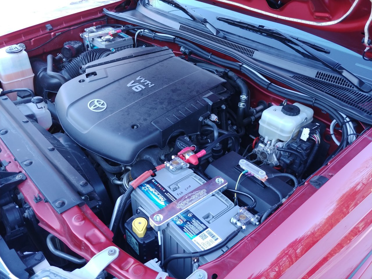

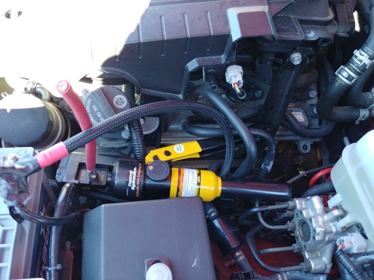

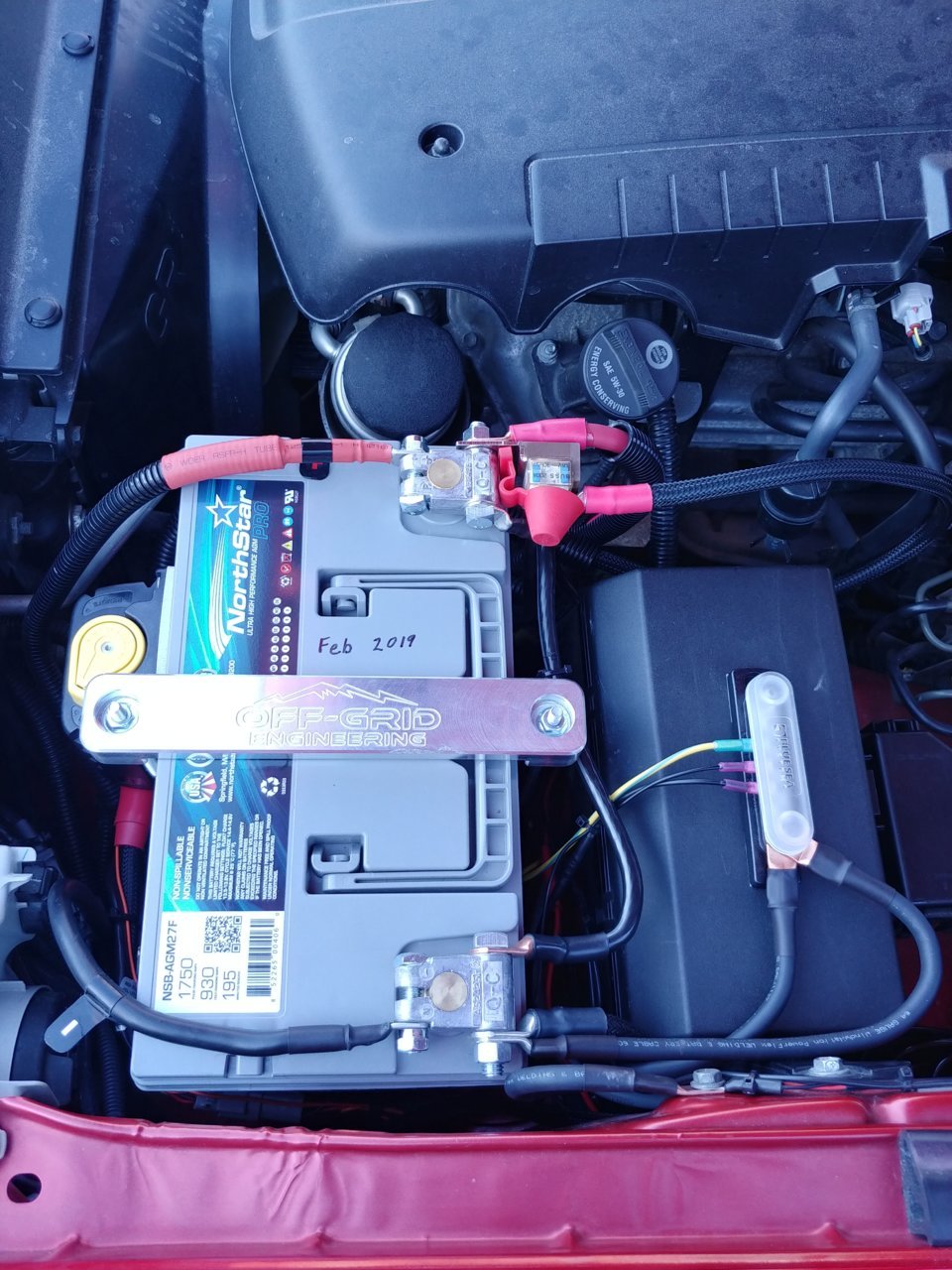

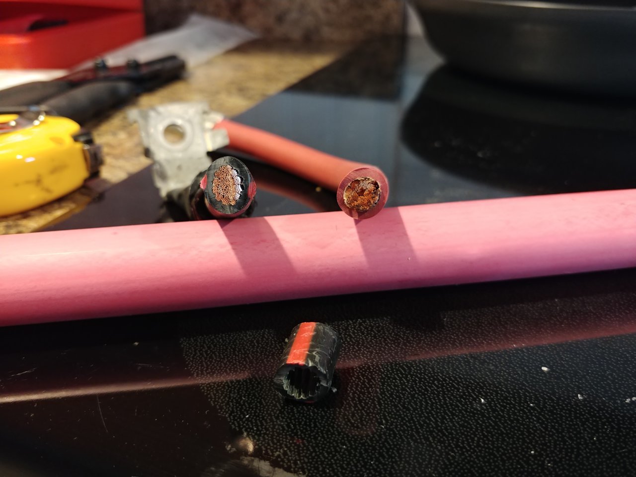

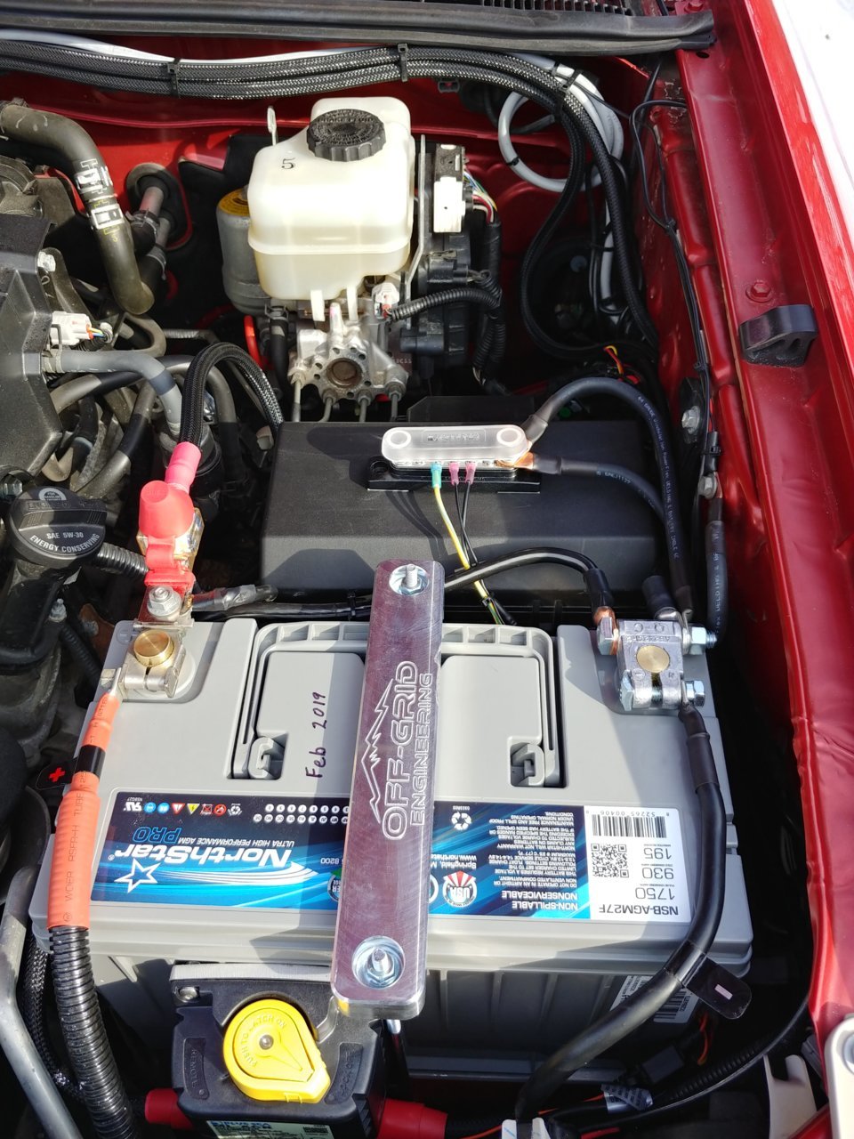

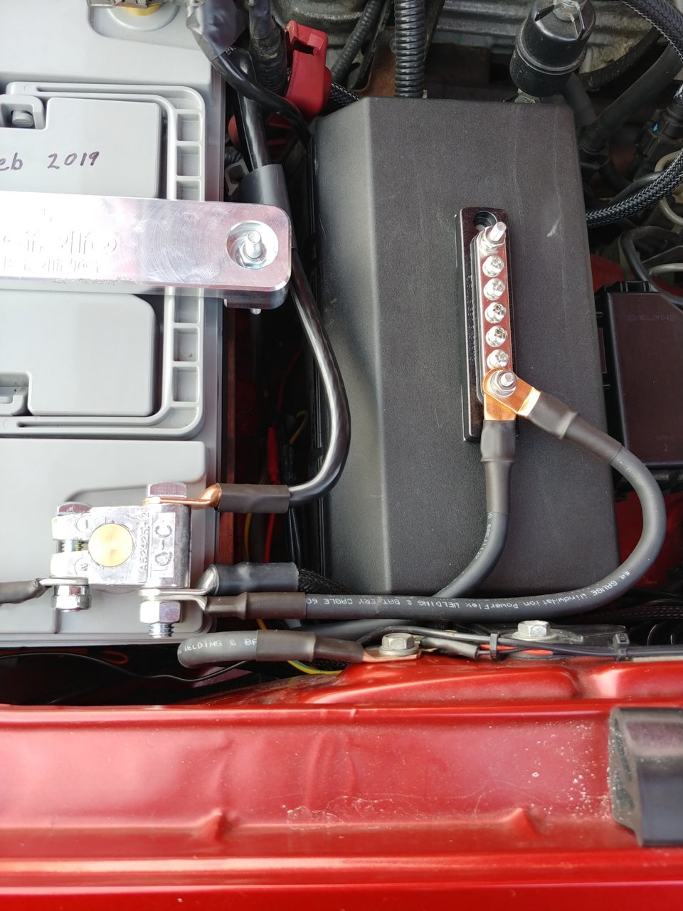

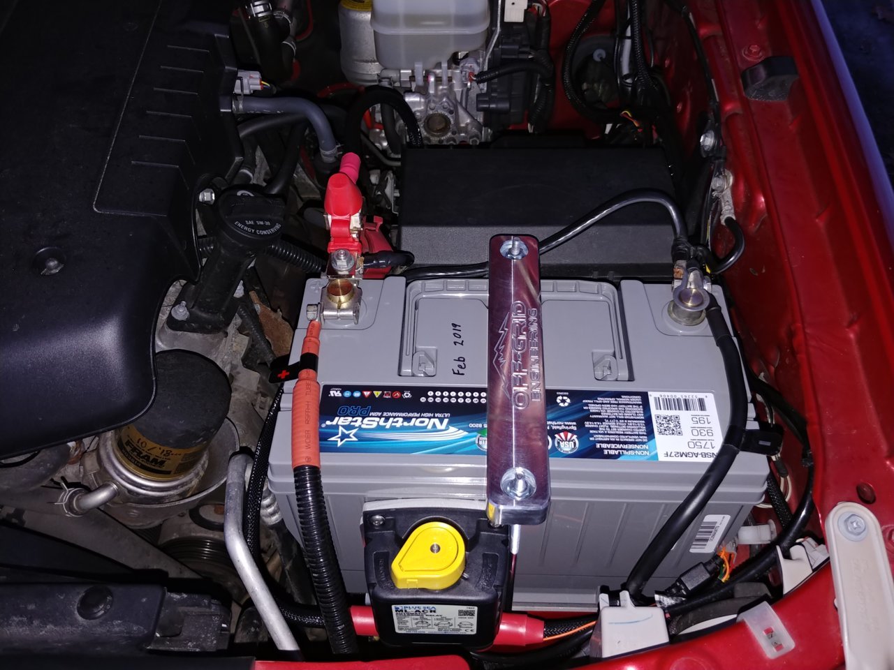

    Finally got the pos. lead extended for the starter motor which means my install is finally complete.
    For future reference: I can confirm the factory pos. and neg. wires to the starter are 2 gauge. Factory pos. wire to the fuse box appeared to be 4 gauge.
    Cut off the factory battery terminals and crimped new lugs on everything. Re-did the chassis ground in 4 gauge and added a neg buss bar right there. Added about 5 inches of 2 gauge to the factory pos. lead. Big butt splice, some adhesive lined heat shrink, and loom cleaned that up. Actually used the 0 ga. jaws in my HFT crimper cause it seemed to crimp the splice best. A high quality crimper should really be on my list of things to acquire..
    Anyway, some pictures of the process and final product
    2 gauge
    A three handed job
    Done and done!

    How is the ML-ACR mounted? Is that a piece of aluminum that comes up that the battery sits on?

    Yup. It mounts on a piece of aluminum welded to the main tray on the front side

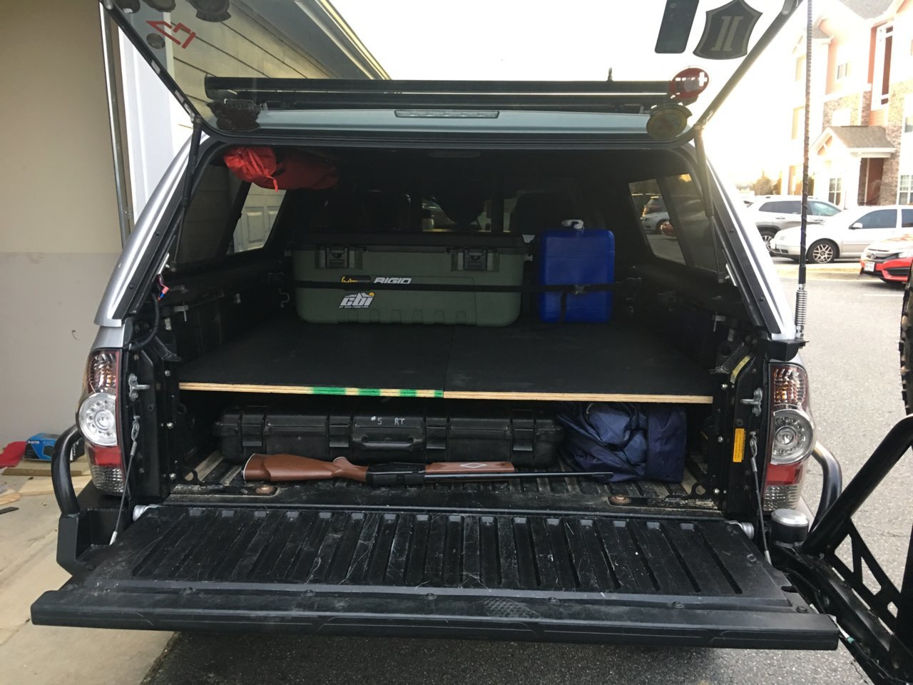

    im looking for a solution, i am planning on running a second battery in my truck bed behind the cab. Im looking for a place to run the 0g wire through to the rear that would be most efficent. I do go offroad and go through my fair share of water so i really want to avoid drilling up through the bed because i dont want water to come in under my drawer system. I also have a camper shell so over the side wouldnt work
    preferably under the wheel well line
