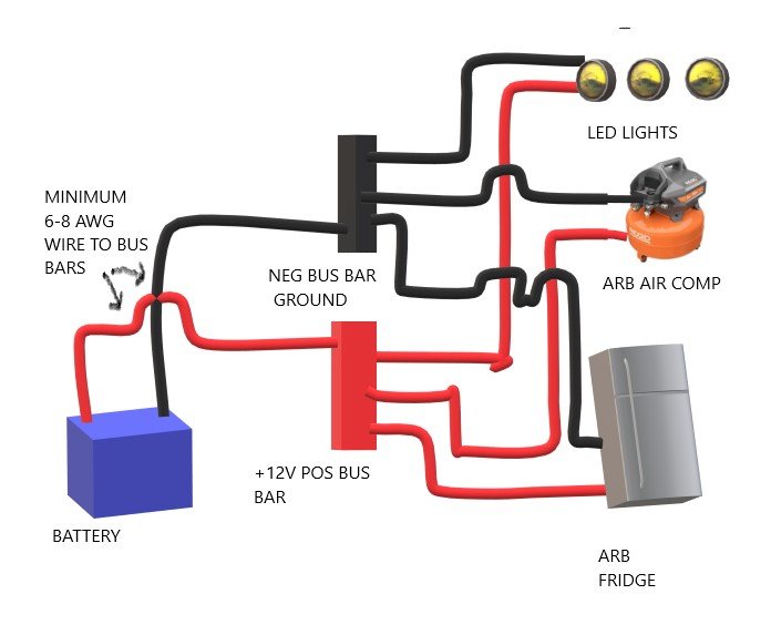

    is this an acceptable way to wire up accessories

    :rofl: No.
    Those are going to run constantly without some relays and switches.

    ugh this was a rough drawing switches were a gimme

    my question is will the 6-8AWG wire be sufficient to send the load to the bus bar over the 12inch or so run
    what I did (notice the sPOD)

    What your total power draw for everything connected to the bus bar? Assume everything is running simultaneously.

    everything on the busses would normally hook up to the battery posts I just installed these and added one larger guage wire off the battery post vs 4 or more

    I have no idea

    Run 4g minimum. If you ground your neg. bus bar to the frame and battery, you can ground your accessories to your frame and save money on wire if you want.

    What is the combined wattage of the lights, compressor, and fridge?

    I don't have a fridge I was just using as an example. as for the lights/compressor :notsure: LEDs cant be much and the comp doesn't run long since I don't have a tank to fill (unless I'm using for tools/air ups)
    ill probably mover everything back to the secondary battery on the mil connectors once I get the OGE set up

    Well, without knowing what wire type you have the 4awg is probably my good to ~80 amps. Multiple by 12V would give you a total 960W. Factor of saftey of 2 and you can probably safely run 480W.
