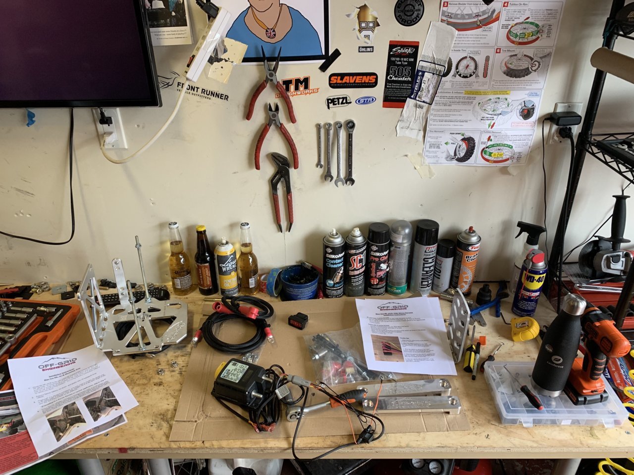

    Bought the Off Grid Engineering dual battery kit with the wiring harness. It's pricey, but after consulting with some TW members I went for it. I have to say, a fantastically well put together kit, everything is right there and ready to rock. I n00bed up and bought the wrong battery size, but fuck it, they fit and they are essentially identical to the stock size in performance.
    Factors that added complexity to the install, in order of importance:
    1. my electrical incompetence
    2. my mechanical incompetence
    3. my inveterate impatience
    4. rock lights kit installed in the engine bay
    5. warn winch control relocation kit, into engine bay
    the kit (plus workbench miscellanea):

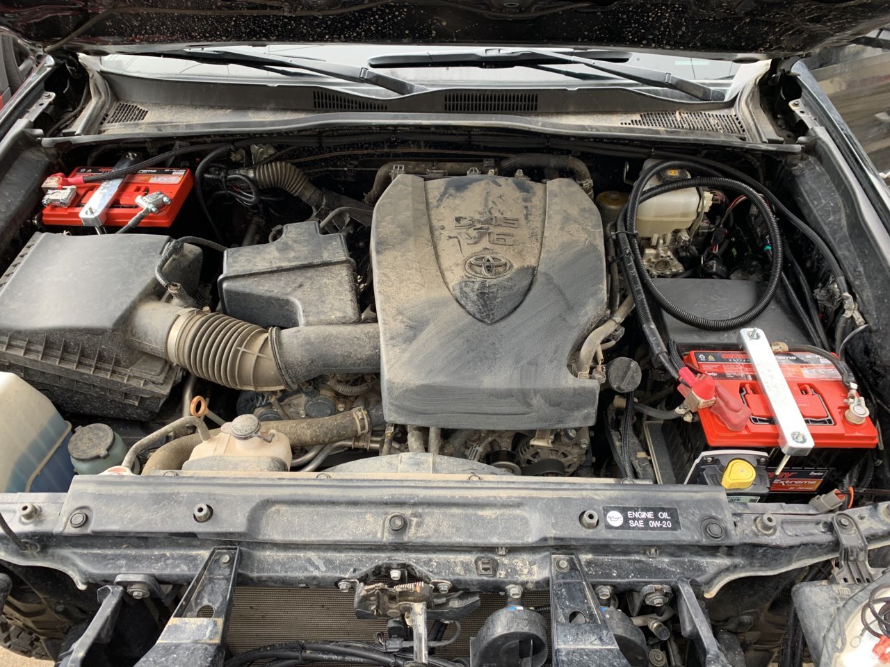

    before (yes I like driving through mud):
    after!:

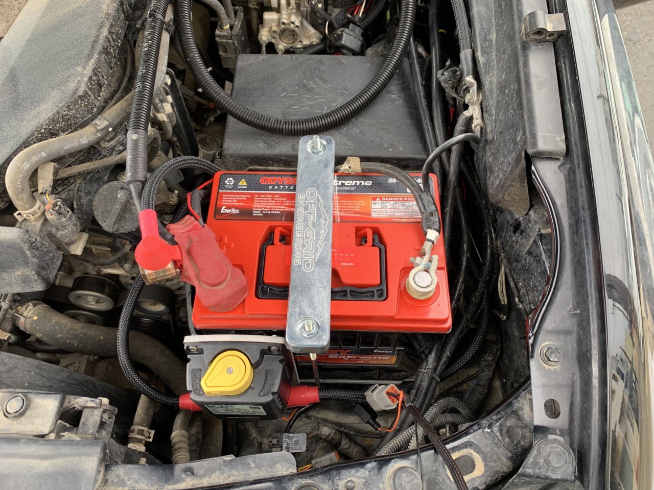

    primary battery, with the Blue Sea 7622 ML-ACR (the control switch is out of shot, just zip-tied into the engine bay for now until I figure out my in-cab switch solution. Janky positioning is courtesy of me buying the wrong group battery :)

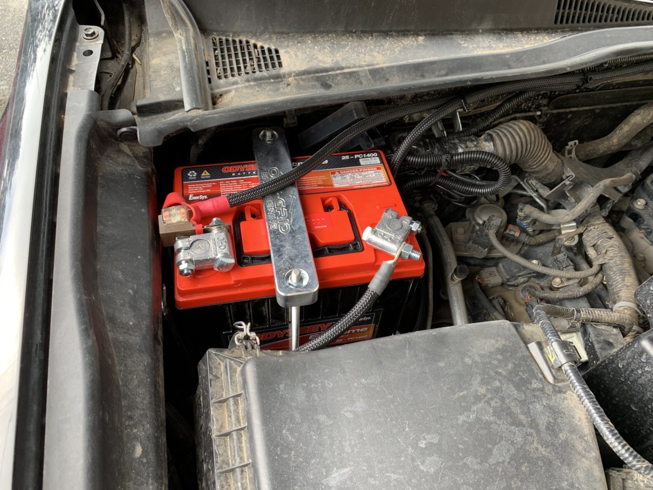

    auxiliary battery (ditto on positioning):
    JiminMaine, Sna and WetTaco like this.
