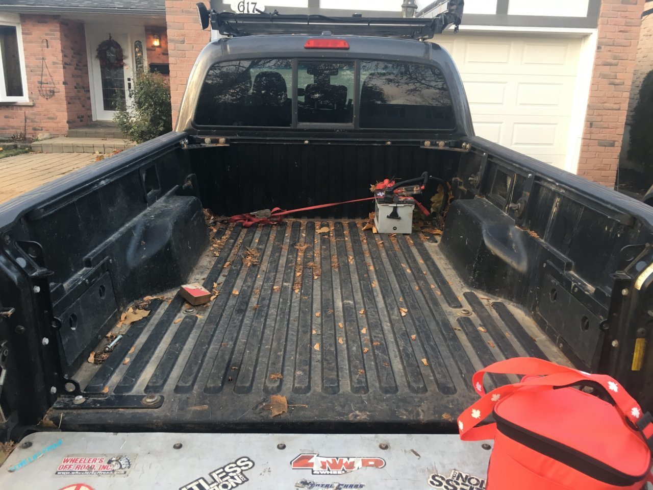

    Not the best pictures. Used one of the stock drain holes as a start, made an aluminum base and had aluminum brackets on the bottom of the bed acting as large washers to ensure the composite was safe. Not the best picture and no wires hooked up yet.
    I used the same system on my flatbed and it has so far held up
    This picture is when I was taking the bed off so it was more to show the condition of the bed and not necessarily the battery. Also why my home made bracket is gone. Wires just came up in the space that was left.
    Greg.Brakes.Tacos likes this.

    Nice, looks good. I just don't think I have drain holes in my 96 unfortunately. I'm going to just drill a hole through the bed liner and then through the bed to run my 4AWg wire through. My dual battery is in my engine compartment, running my positive lead to my inverter and fuse panel in the bed.
