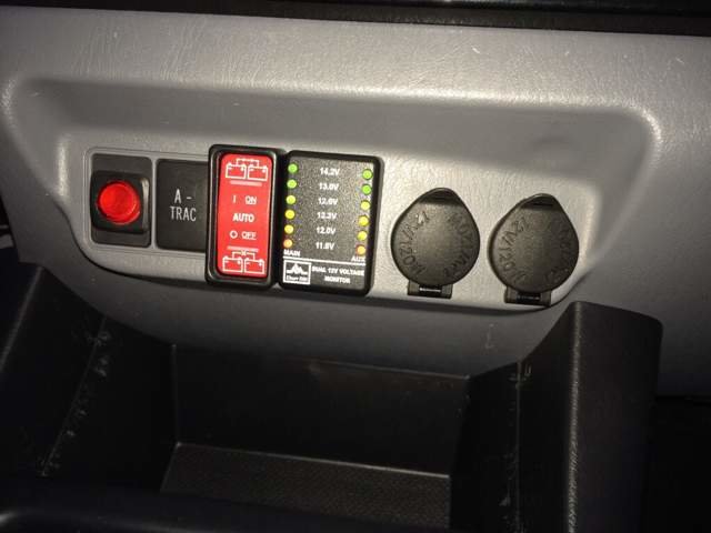

    Regarding the Peak DBI led dual battery monitor Linus installed:
    Although it is available on eBay (http://www.ebay.com/itm/12V-LED-dou...er-indicator-for-car-4WD-camper-/321316229493) for $20.95, shipping is $30. You can purchase it directly from Peak DBI here:
    http://peakdbi.co.za/product/12v-led-double-battery-voltage-level-monitor/
    It'll run R 210.00, which is $19.53, to Missouri cost $3.46 shipping, for a total of $22.99.
    Combined with the Blue Sea ML-ACR 7622, this looks like the perfect setup to me.

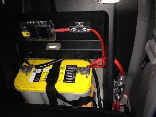

    I'm going to mount my second battery behind the rear passenger seat like Alex:
    Coupla questions though:
    The optima yellow top is deep cycle, with this setup can I be sure there are no issues (premature death of optima) if I keep (for now) my original battery as main up front?
    What model number of optima would you recommend (for aux)?
    Keeping an eye on $$ (no lithium), what battery combo for front (main) & rear (aux) would you recommend?

    Get as large as you can fit for a second battery. A Group 31. If you are spending the money. Might want to consider one of the Diehard Platinum Group 31's from Sears. Theres a thread on here somewhere with the sears discount code. You get them at a great price.
    A single group 31 WILL fit in the stock location. Just buy the extension hooks from the local Auto Parts store for $3-$4 and you are ready to go.
