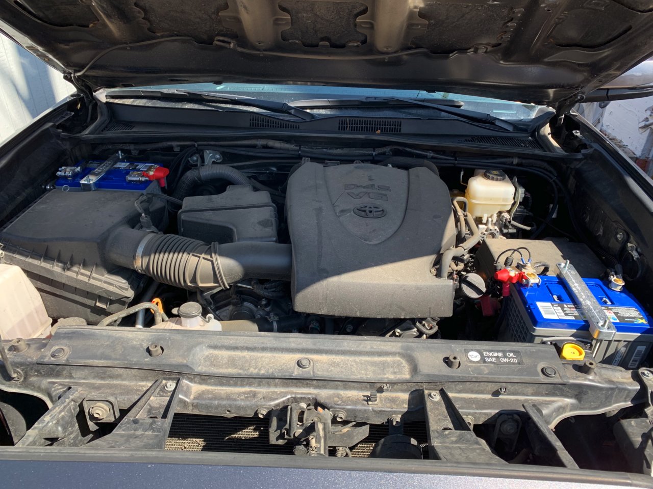

    Off-Grid Engineering Dual Battery System with X2Power Batteries. Still need to install an aux fuse box and move the bed lights over to it.
    tacoburn327 and SR-71A like this.
