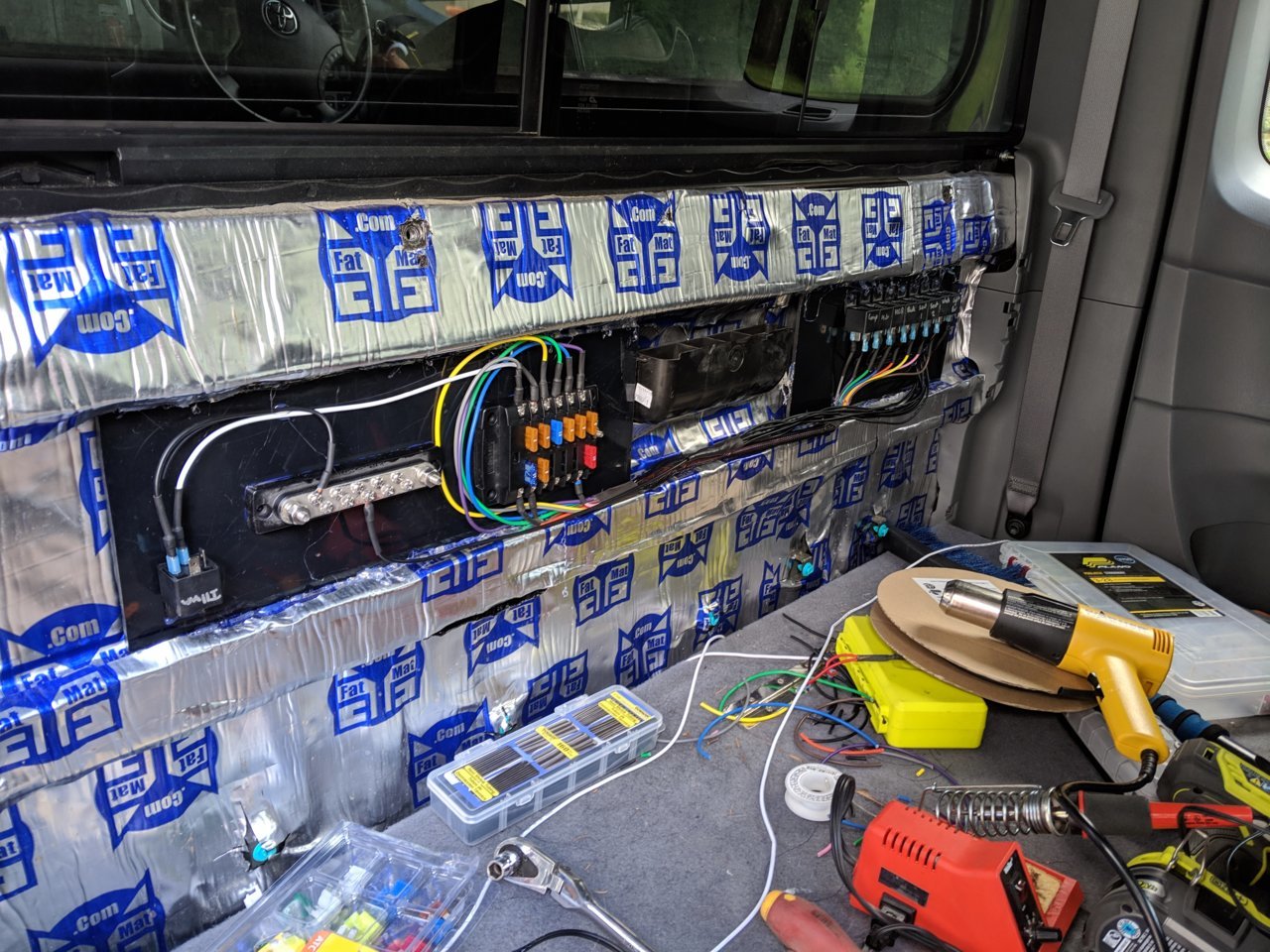

    Looks good. Very similar to what I did behind the panel of my access cab

    Yours gave me the idea....2 or 3 years ago or whenever it was you did it lol. Literally taken me htis long to get around to it

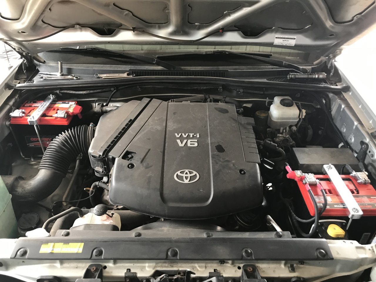

    I would probably turn the battery closest to the fender well 180 degrees. The battery posts seem too close to another metal object.

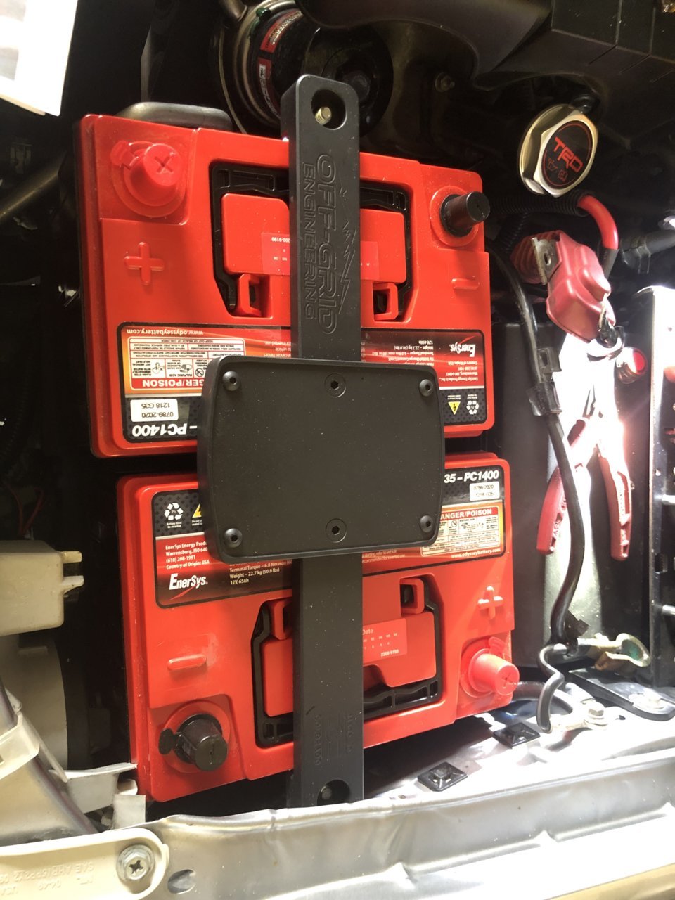

    Got the OGE set up. Can’t even see the wires DA9EDD50-6663-413B-95FE-6D980332CFC1.jpg
