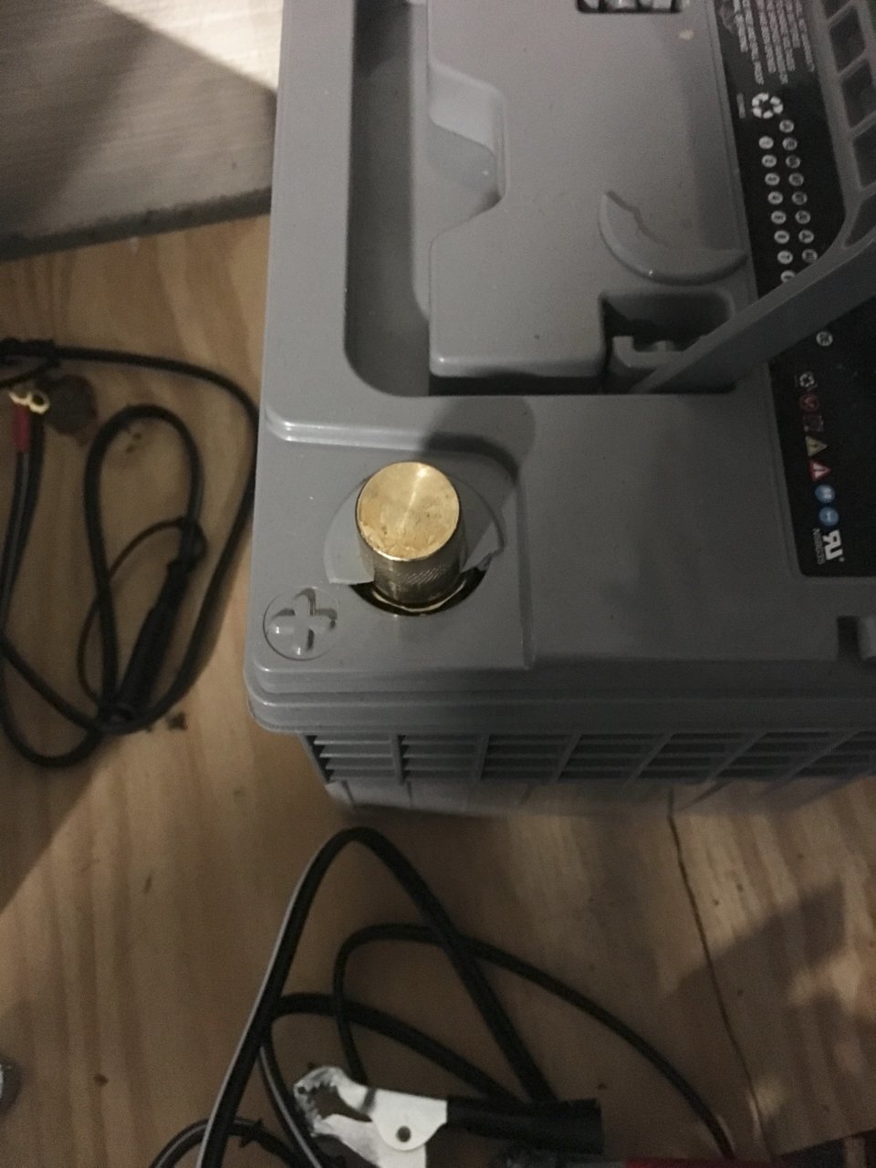

    What’s you guys opinions on this? I was trickle charging my batteries before I could get them installed and I noticed the case is cracked around the post. I took it off the charger and it was a little “wet” around there. (Two batteries bought the same day, only one did this) put both batteries on trickle chargers after a few weeks of being off and they charged up in the same time frame. Should I glue this piece back to the plastic? Not worry about it? 22287B77-E4C3-49F3-8E5A-16F8AD150A7E.jpg

    I wouldn't think it would cause any issues an long as you seal that hole back up. But you could contact Northstar and ask them. They'll probably say its fine, but might offer something else, idk. (Im assuming its a Northstar battery..)

    It is a NorthStar. I’ll contact them, thanks
    From NorthStar -
    It seems that the cosmetic snap fit terminal cap was broken. This could of happened if pushed inward. This does not impede the performance of the battery, and is merely there for cosmetic reasons. If you see below the brass terminal the bottom of it is a hex head which can be backed out if needed, this cap just covers this gap between the battery lid and cover. The seal of the battery is still intact. You can certainly glue back the cap if needed.

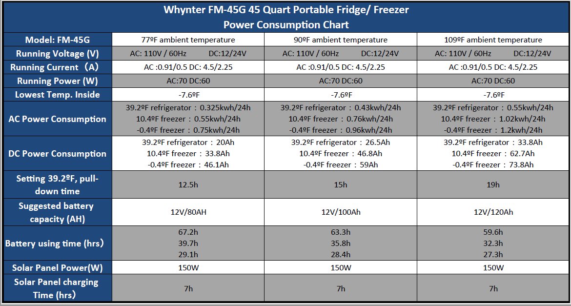

    nah im not planning to add a dc-dc charger at this time. simpler the better im thinking. just trying to get extra run time on my fridge without killing the starter battery when the truck doesnt run for 2-3 days.
    i dont have the air pump in the way anymore so i was thinking ill have plenty of room but i havent done measurements yet
    fridge i have:
