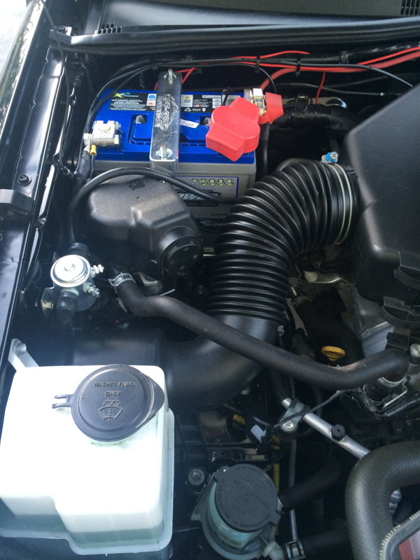

  14. Oct 28, 2019 at 7:03 PM
    #2534
    seafur
    seafur Well-Known Member
    Jul 11, 2014
    #133755
    115
    Pacific Northwest
    2014 DCSB MT TRD OR
    Sprinter bed tiedowns, Aux fuse box, AIO key, 3-way canopy light switch, 12V bed outlet, Dual Battery AGM G35, Viair OBA, Uni-filter mod
    pokey1416 likes this.
