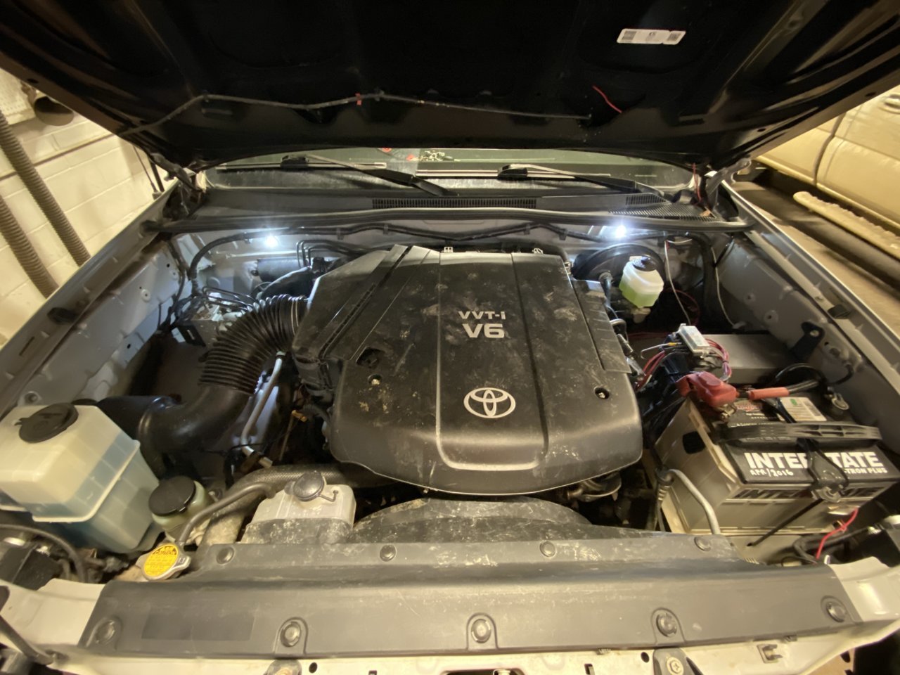

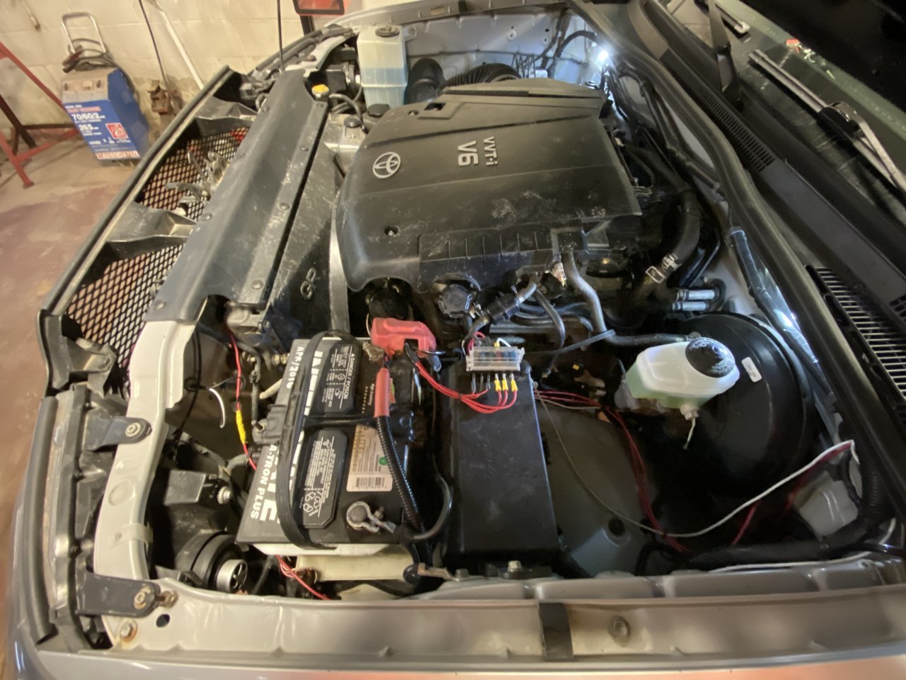

    I just finished installing the trays and ran wires for the OGE kit. I am wondering the best place to attach a ground on the passenger side. The OGE kit uses the two bolt holes on the passenger side and I already have the battery installed so I really don't want to pull everything back out. Any suggestions for getting a solid ground?

    Installed the same kit myself this past Sunday. Used Optima yellow tops.
    What about the bolt in the bottom left corner?

    What hasn't been modified?
    Make a longer to run directly to the frame? And or direct to motor and one to body panel
