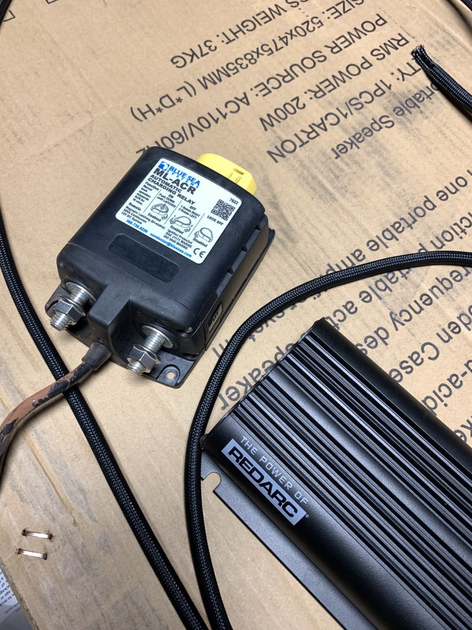

    Getting all my parts together to do my dual battery install. I already have the ML-ACR but was also thinking of switching to the redarc.
    What made you end up switching?

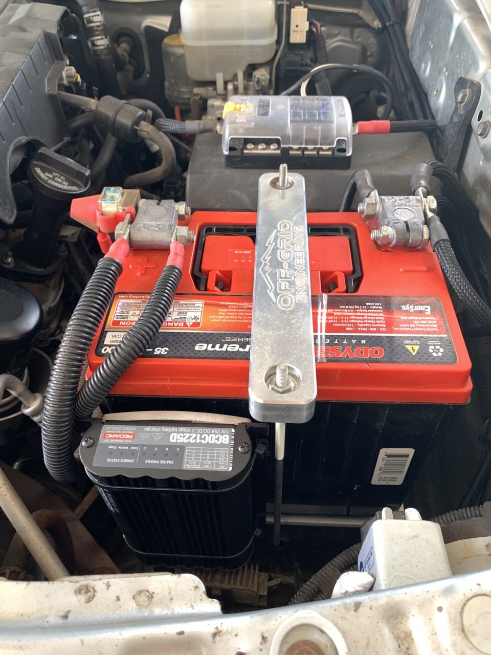

    My Odyssey batteries for some reason weren’t liking it. My starting battery would alway drain. Luckily, using the ML-ACR, I was able to connect the batteries and start my truck.
    Atleast now, I know my secondary battery will be topped off. If I remember, I’ll put my starting battery on a charger once a month or so.

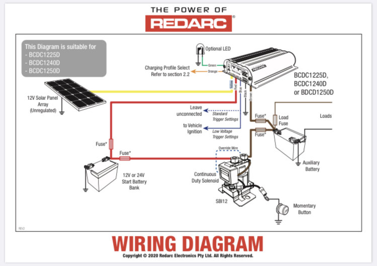

    So the Redarc has the ability to tie or separate the batteries just like the ML-ACR?

    it does not have the ability to tie the 2 batteries. It ensures the secondary battery is properly charged.

    The ml-acr directly connects them together. It does not control charging it leave that for the alt. Wiring needs to be larger so you can link to start if the main battery is dead.
    the red arc is a charge controller. Aka it can charge the second battery from the first but does not connect them together.
    To self jump you would need to carry jumper cables to link the batteries

    Yup. I was just confused by his post a few back when he said he went from a ML-ACR to a Redarc. In my mind that implied the Redarc could do both, which wouldn't make any sense electrically.. :thumbsup:
