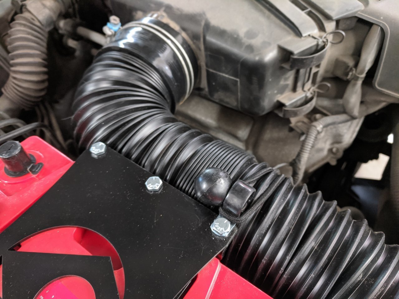

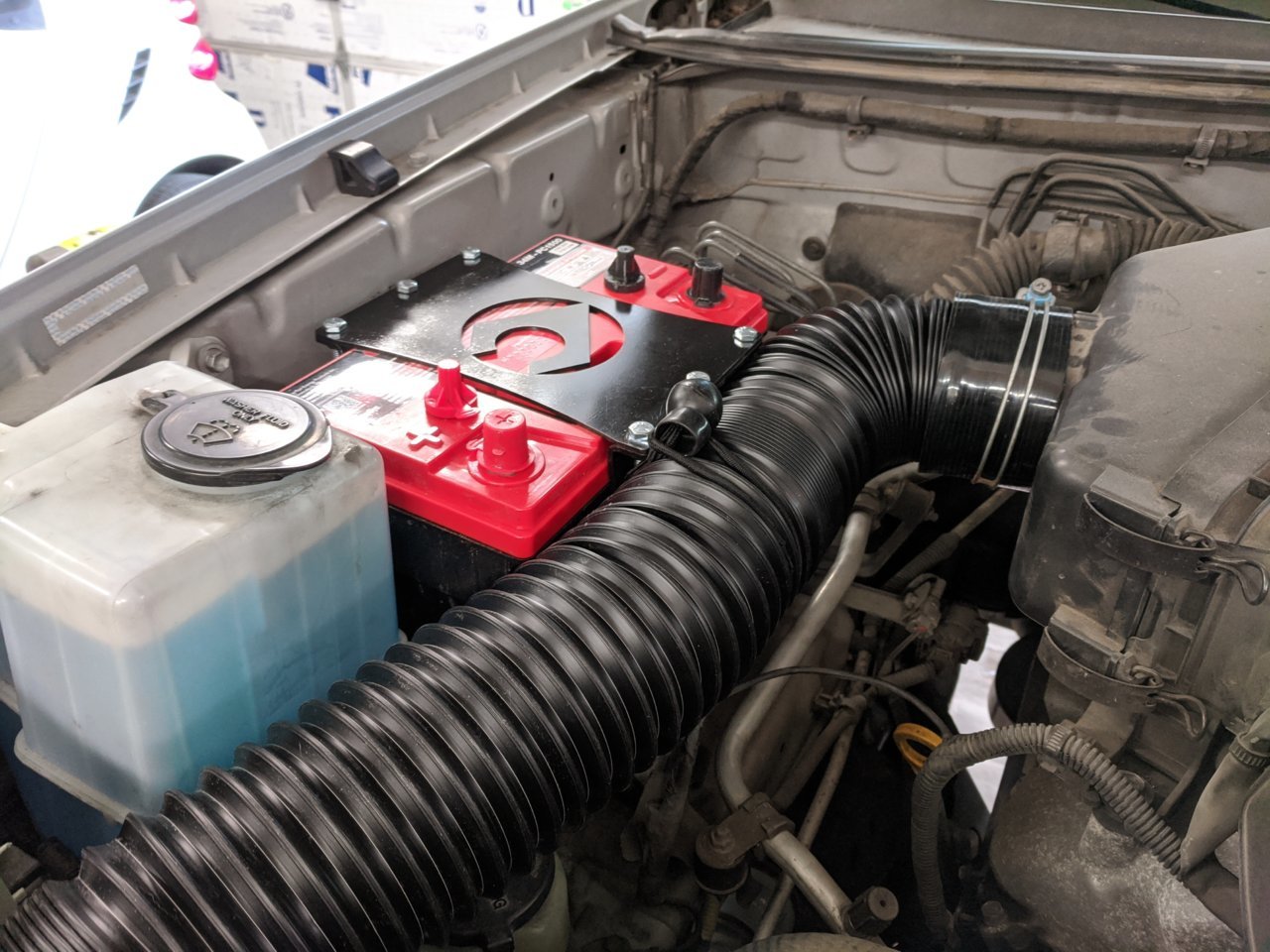

    Saw this thread popping up again on the home page and thought I'd go ahead and share this. I've been running this setup for about a year and a half. This plywood and lumber battery box is mounted in the bed of my truck under my AT Habitat. My fridge sits on top of it (2nd pic). I have 2 Blue Top Optimas, group 27. They are connected to my starting battery through a Bluesea ML-ACR. I never actually switch the ML-ACR to connect the batteries unless it's to jump my truck (recently replaced original battery with a yellow top optima, so hopefully no more jumping). Charging the batteries before I leave home with the Noco Gen2 charger and then using my 100 watt solar panel to keep it charged while camping hasn't failed me yet. Max trip was around 5 days so far. Main drain is the 75 liter Dometic Fridge.
    My original plan was a second battery under the hood, but decided two extra batteries was better than one, and I mounted my ARB compressor under the hood instead.

    Do your batteries match? Curious if there would be any issue with the solar attached to one of the batteries, and then to the other battery via the ML-ACR. If it's connected the whole time would one battery be sucking juice from the other battery, not just from the solar panel? And could it be an issue?

    I didn't plan it this way, but after having it installed for months I realized with the ML-ACR attached to a manual battery switch I could have my fuse block/solar controller hooked up in between. So if I disconnect the battery at the switch, and connect the ML-ACR I can run my stuff off the Truck battery, and charge it via solar. Then if I disconnect the ML-ACR and flip on the Battery switch I am running completely off the House Battery, and charging just that battery. I originally installed the switch because I had two house batteries i wanted to separate (4 position switch: bat 1, bat 2, bat 1+2, off). A standard battery disconnect would work with just the single house battery.
    Did that make any sense? lol.
