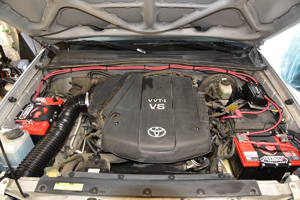

    John90XJ
    John90XJ Well-Known Member
    Aug 11, 2019
    #301865
    86
    John
    2006 Tacoma Access TRD OR
    More to come as the project moves toward the rear of the rig tomorrow. Tonight, the second battery is in, wired, the CTEK charger is working as intended and I got to make five custom cables. All in all not a bad day of self quarantine. I'll be adding some Blue Sea outlets for the ARB fridge and other general purpose use and then figuring out what I'm going to do with all this power.

    I would have thought the opposite. Home to get you home.
    BrotherBudro likes this.
