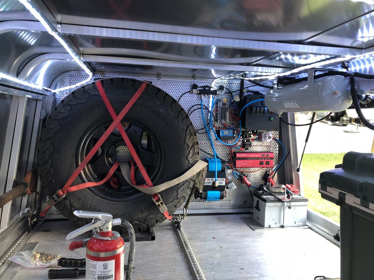

    Several companies build battery cages, for that (or similar) purpose.
    I have both of my Odyssey batteries in cages - one under the hood, the other in the bed.

    Do you have pictures/details of your bed setup?

    Scott B. Well-Known Member
    Nov 11, 2014
    #142118
    4,478
    Scott
    Georgia
    2015 ACLB SR5 4x4 Expo
