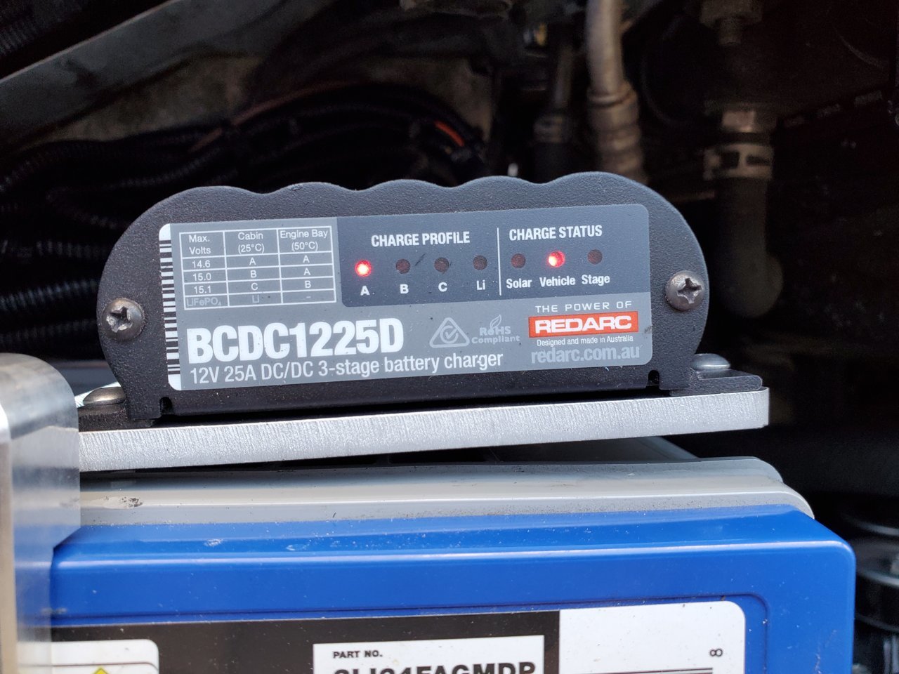

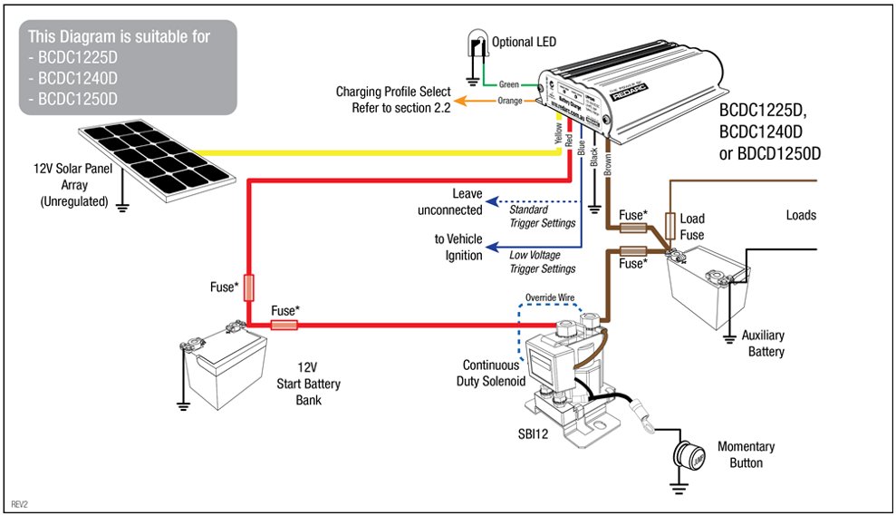

    I think currently the only way to do that set up is custom. But you can use the OGE RedArc BCDC tray under the factory battery location, then run the Auxiliary battery wiring back to the second battery in the cab. It is something I can bring up in the next meeting.

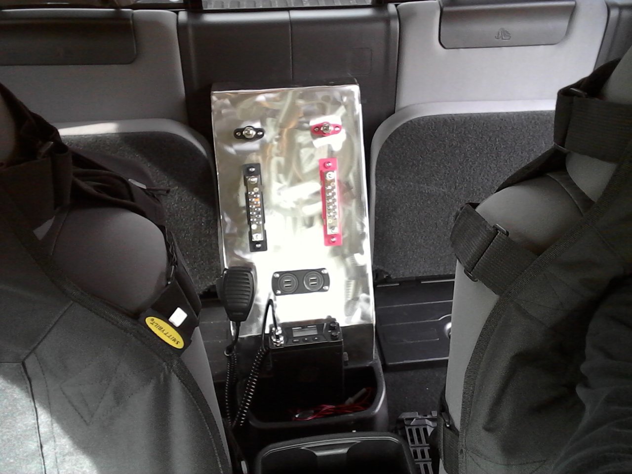

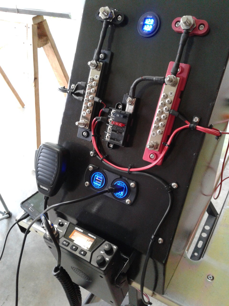

    Yeah I was going that direction a while ago. I was going to mount it under a box I fab'd but started thinking about space and other things. The venting thing was from my application. I was using a wet battery before I went solar/agm. I never did like the idea of a battery in the cab of the truck tho. It's just not up my alley but it was going to work. Then I built the cap/topper. I would still reconsider it in the cap. Lots of things to go wrong in my opinion. A good fabricator can secure the battery. I'd weld the bracket to the bare floor, and use a commercial heavy duty metal tie down, commonly used in racing. I made my own and I trust it. It really boils down to each guy's capability's. I'm blessed to have the gear and training. I've seen bungee cords and clothing belts used on batteries....lmao.
    My old idea below.
    Zim
    Edit: The Cadillac and Tahoe have the battery in the car, but inside a secure area with a lid...
