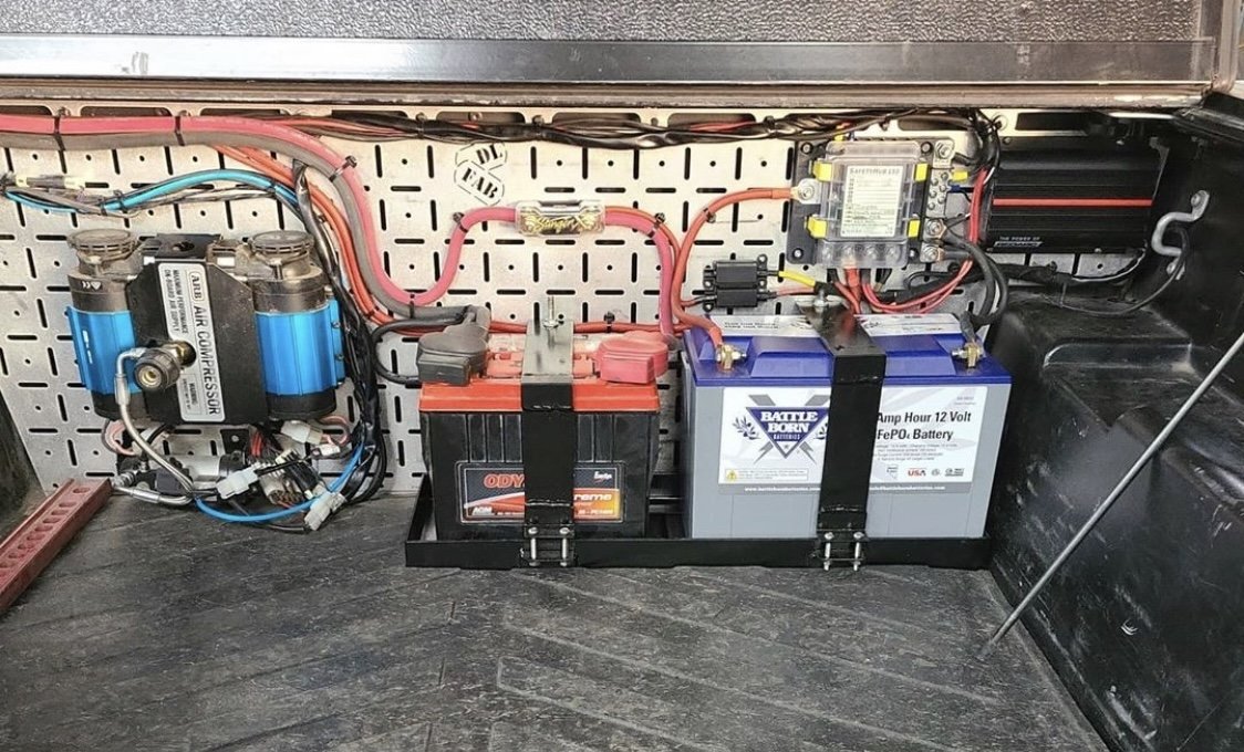

    Im going to do something like that. Already have the 2nd battery in that location, and my solar charger (which I want to switch out to a CTEK or Redarc)(And I hope its waterproof because its been outside for over a year :rofl:). I just need to get some wires and loom and work on making my stuff clean like that. I wont be putting my air compressor there.

    How is it running an agm and a lithium at the same time?

    On that picture? Id think that one is the starting battery, relocated to the bed. And maybe the Redarc is inbetween?

    Ahhhhh.....makes sense now. A relocation is a tricky thing.

    Looks like the odyssey is the starting battery relocated to the bed with the Lithium as the house battery. Controlled by a REDARC BCSD1250 in the top right corner controlling them.

    I have a gel and a agm. But they are not linked.

    Maybe there are three batteries? OH HOLY BATTERY MYSTERY....LOL
    My truck has a starting battery, (wet) because that's what it's supposed to do, and I have a AGM in the bed, for lights, refer, radios and when it's time, I may add a 3rd for the winch, air compressor, and welder.
