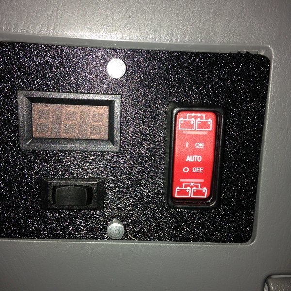

    I ended up putting mine here. If you don’t mind losing the coin holder it could be an option for you. One thing you might want to consider is having the red light staring at you all the time which can be annoying. I didn’t want that but wanted easy access to the switch if needed. The ML-ACR pretty much a set it and forget it switch. In all honesty I don’t think you will be using the switch much at all.

    Oh shit I like that idea. Im assuming thats a custom panel you made yourself? What does the other switch do?
    And just to clarify, my system is fully installed and Ive been using it for the better part of two years now. Always use the switch when Im camping as I dont have solar or anything, so I open it when camping, and close during the day to charge. Im finally getting around to moving to switch to a permanent location thats all.. Im good at procrastination haha :anonymous:

    Doesn’t the switch (ML-ACR) automatically separate your batteries when the house starts drawing a load?
    Yes, home made panel out of plastic. The two silver screw looking things are little thumb knobs with tiny latches on the back side for easy access to the fuses. The other switch is for the volt meter above it, toggle one way for start battery and the other way for the house.

    Thats awesome. Really clean solution. I will likely end up trying to replicate something similar.
    And yes, in Auto mode the ML-ACR will do its own thing. But Im OCD and like having manual control over things haha

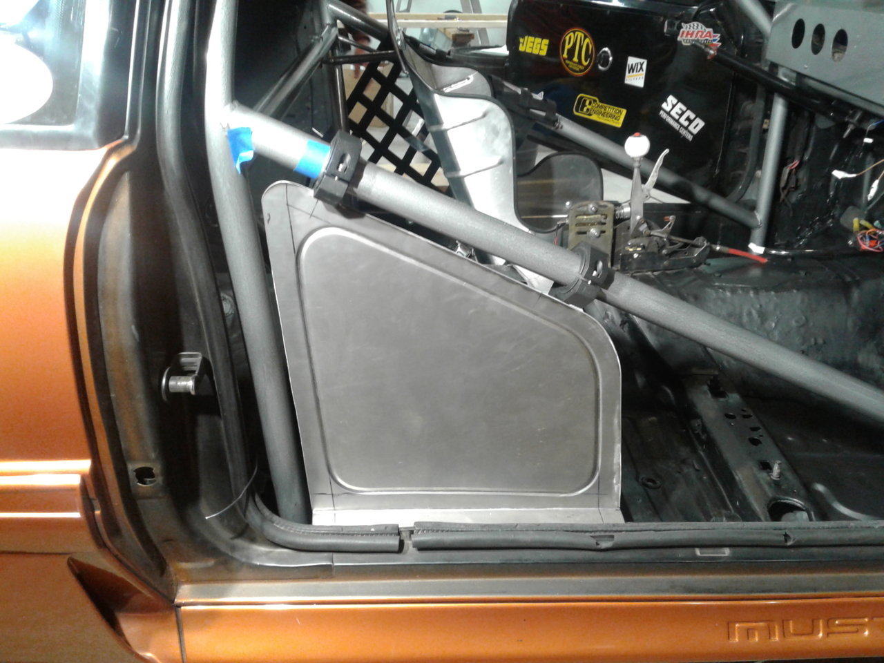

    Awesome. I get my aluminum from Metal Supermarkets. Good folks and will cut it to size if needed. I've got a bead roller and brake so I have a lot of fun with these. The first one is in a friends mustang and second will be in mine.

    very clean! Im looking forward to starting that project in the spring. Not really looking forward to the wiring though

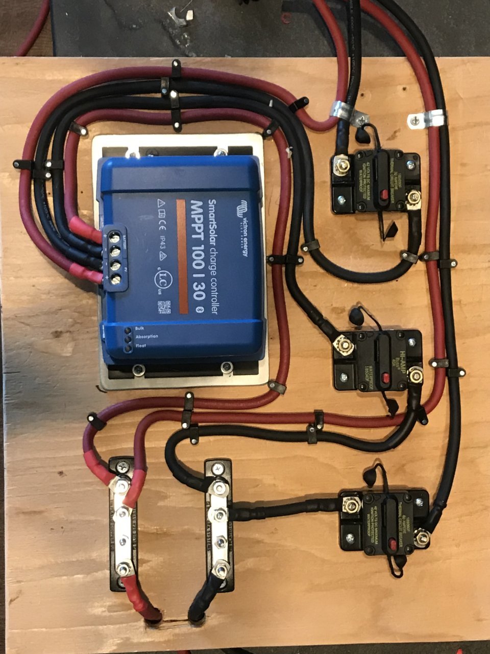

    Do you have any worries about the electrical components shorting out to the metal substrate? Is the substrate grounded so that your fuse will disconnect the circuit when a short occurs? I installed my setup on a wooden substrate, but I worry about fire risk. I mounted my solar controller on a piece of aluminum as a heat sink / shield as it is the item that gets the most hot in the summer.

    No not really. It will be painted but that does not prevent a short to ground. As with any addition to a vehicle, ya got to look at it and make sure it's okay every now and then. Maintenance is the key to everything. Now a accident is a different story. I've been in a rollover and the last thing I worried about was the battery..LMAO. You're right tho, it's food for thought. A good install is the key. If it looks like shit, buy 2 fire extinguishers, not one. LOL

    Why are the breakers on the negative cables?

    My battery disconnect is on the negative. When you disconnect a battery, pull the neg first, then the pos. Truest way to shut shit down.

    But shorts on the positive cables won’t surge the breakers and trip them. They’ll only trip on over current surges that aren’t due to short circuits.
