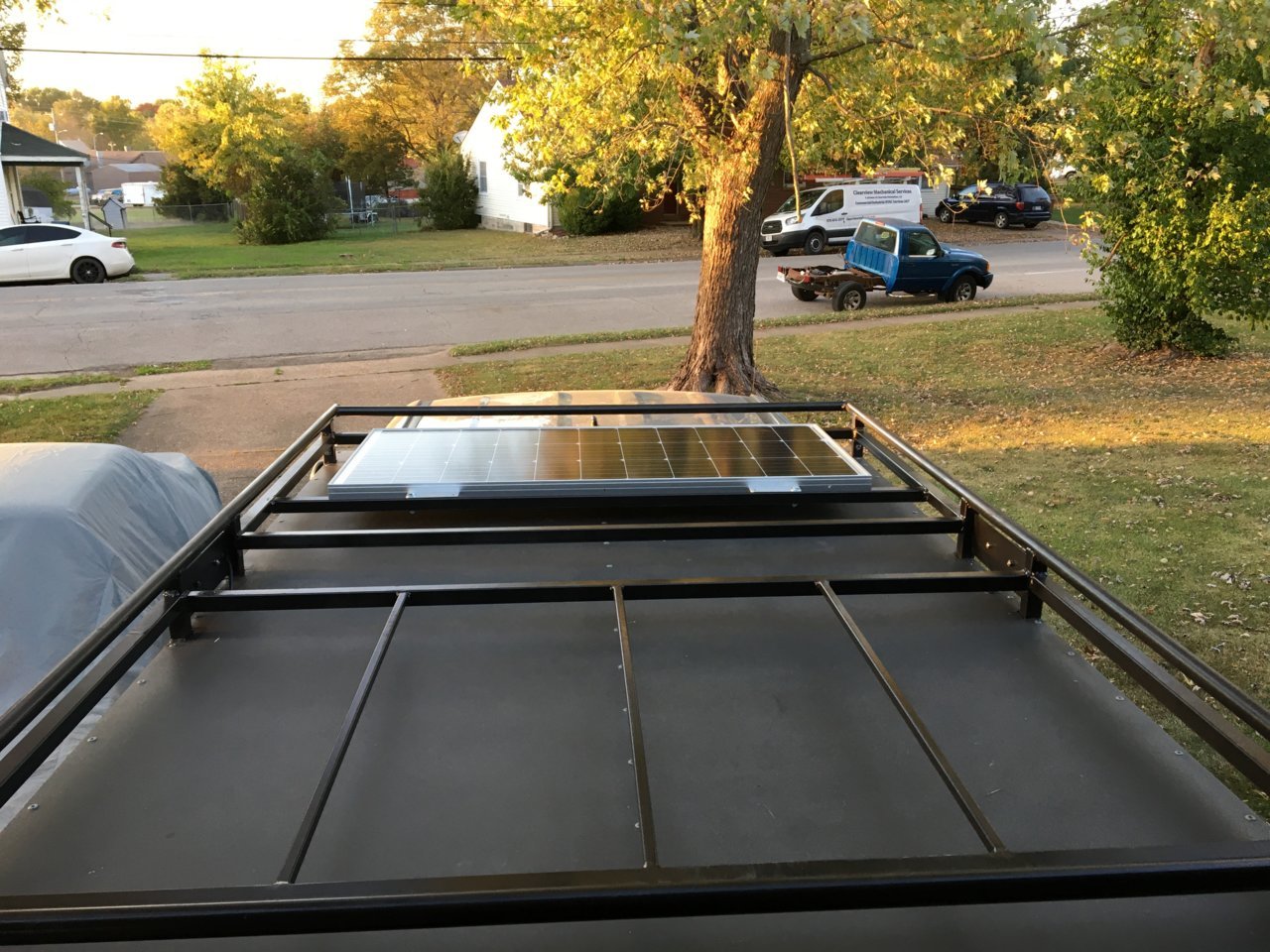

    Mid Missouri
    19 Tacoma SOLD
    As many as I can fabricate
    Yeah I have just the one battery, and in 90* heat it was almost cycled at 8pm (refer)...And you're right about the trees. That's why I'm getting a portable 100W panel so I can move it around in tree canopy situations. (I'm fixed on the roof) I'm loving my set up and testing for the Westward Trips is going well. We've been out at least 20 times in the last 45 days.
    Zim
