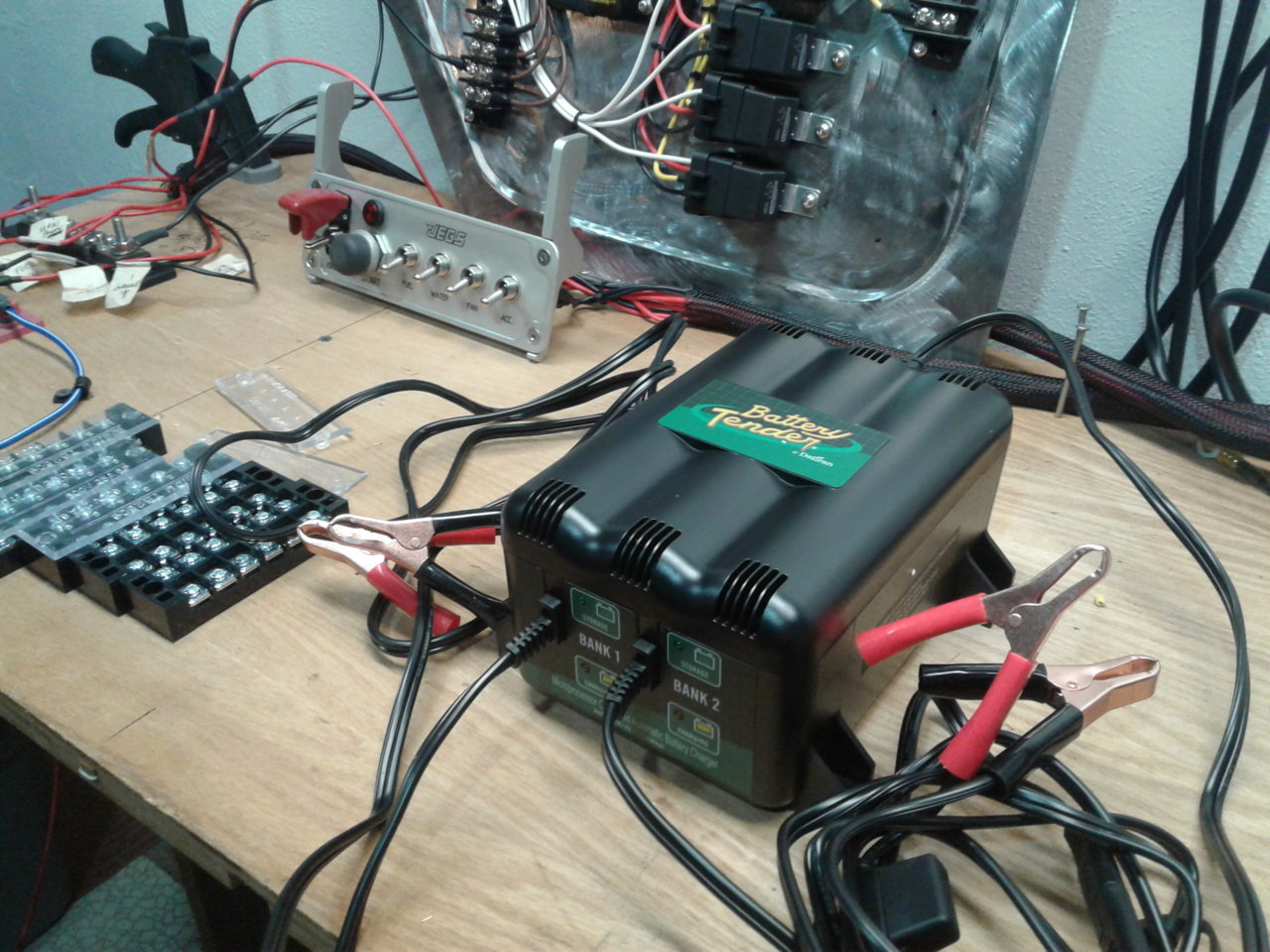

    I have the Battery Tender 2 bank maintainer and it works great, but with the solar I really don't need it. At one time last winter I had the truck and golf cart charging at the same time but rarely am I playing golf and going on a camping trip..lol
