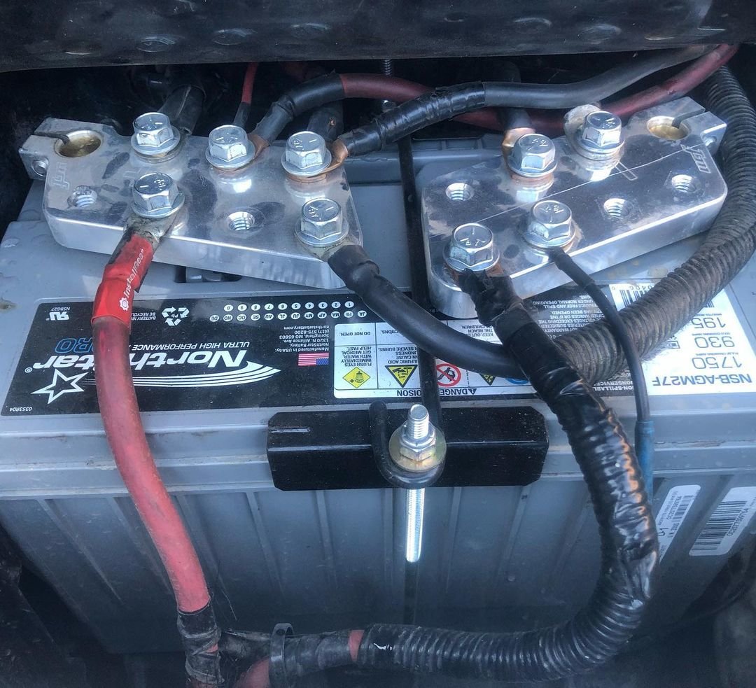

    Ever see battery terminals like these? Where can I get a set?

    Amazon search Vgate very similar

    Yeah, I saw the Vgates. I was still hoping to find these.
    Thanks.

    Looks like some sort of sound system one. But i also dont know anything

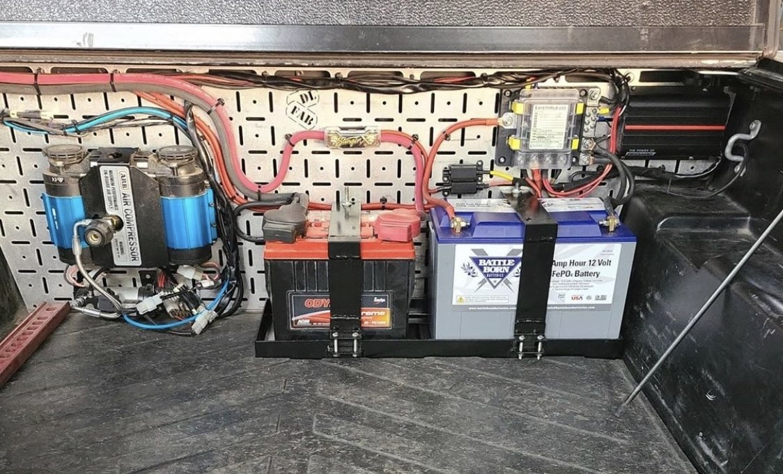

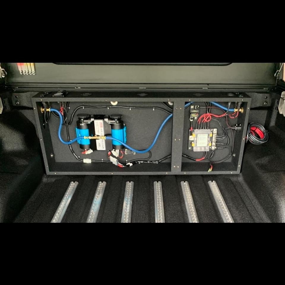

    Im wanting to setup my bed electrical like this, but also being cheap and not wanting to order the aluminum. Is it possible to mount on wood?
    im just going to have my 6 fuse blue sea, battery, breakers, and the CTEK D250SE that I just got in.
    i also like the second picture, but nothing exists in my searches like that. Anyone know the name of it so i can expand my search? I have a 98% dry bed, as this will be mounted inside of my GFC
    Bastek likes this.

    Are you relocating your main battery to the bed as well?
    Wood? Maybe. kinda looks like the box from 2nd pic might be made out of wood/plywood

    Not at this time.
    I thought that second picture was pressed/bent aluminum or steel thats been powdercoated. I just dont have the resources to do myself. I can weld steel, but not aluminum
