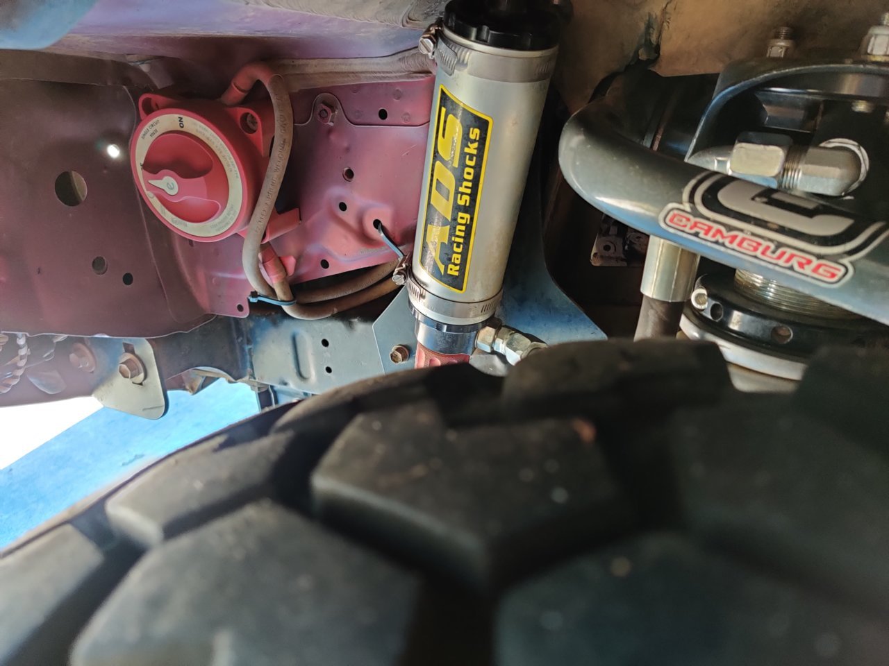

    I Had no room either so I put my switch in the wheel well below the battery. It's been there several years with no issues.

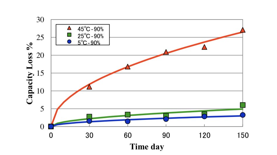

    I have a hard time knowingly subjecting my battery that costs 10 times a lead acid battery to high temperatures.
    it might work for a while, but the data says you won’t get 3000 cycles.
    https://mdpi-res.com/d_attachment/wevj/wevj-07-00025/article_deploy/wevj-07-00025.pdf

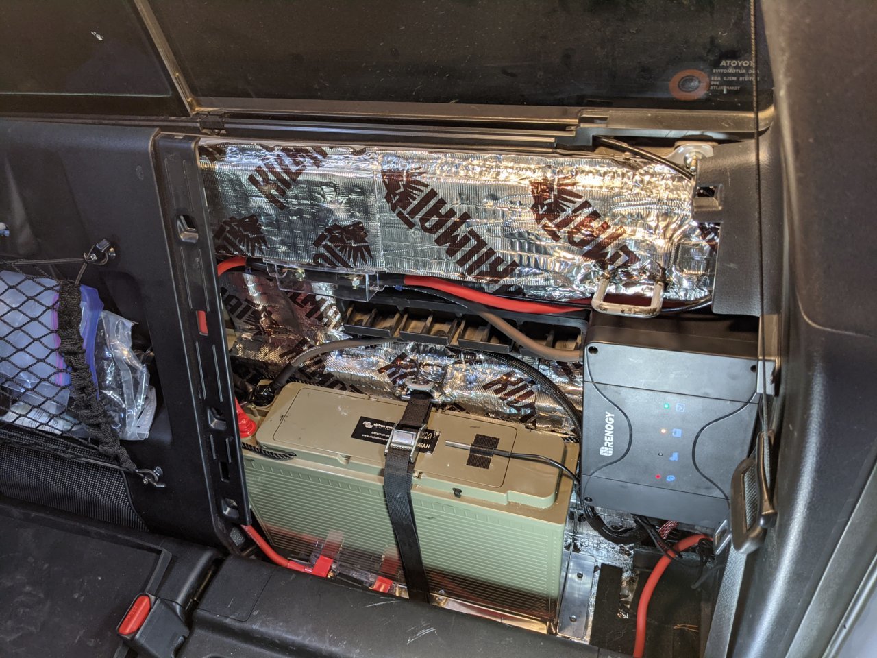

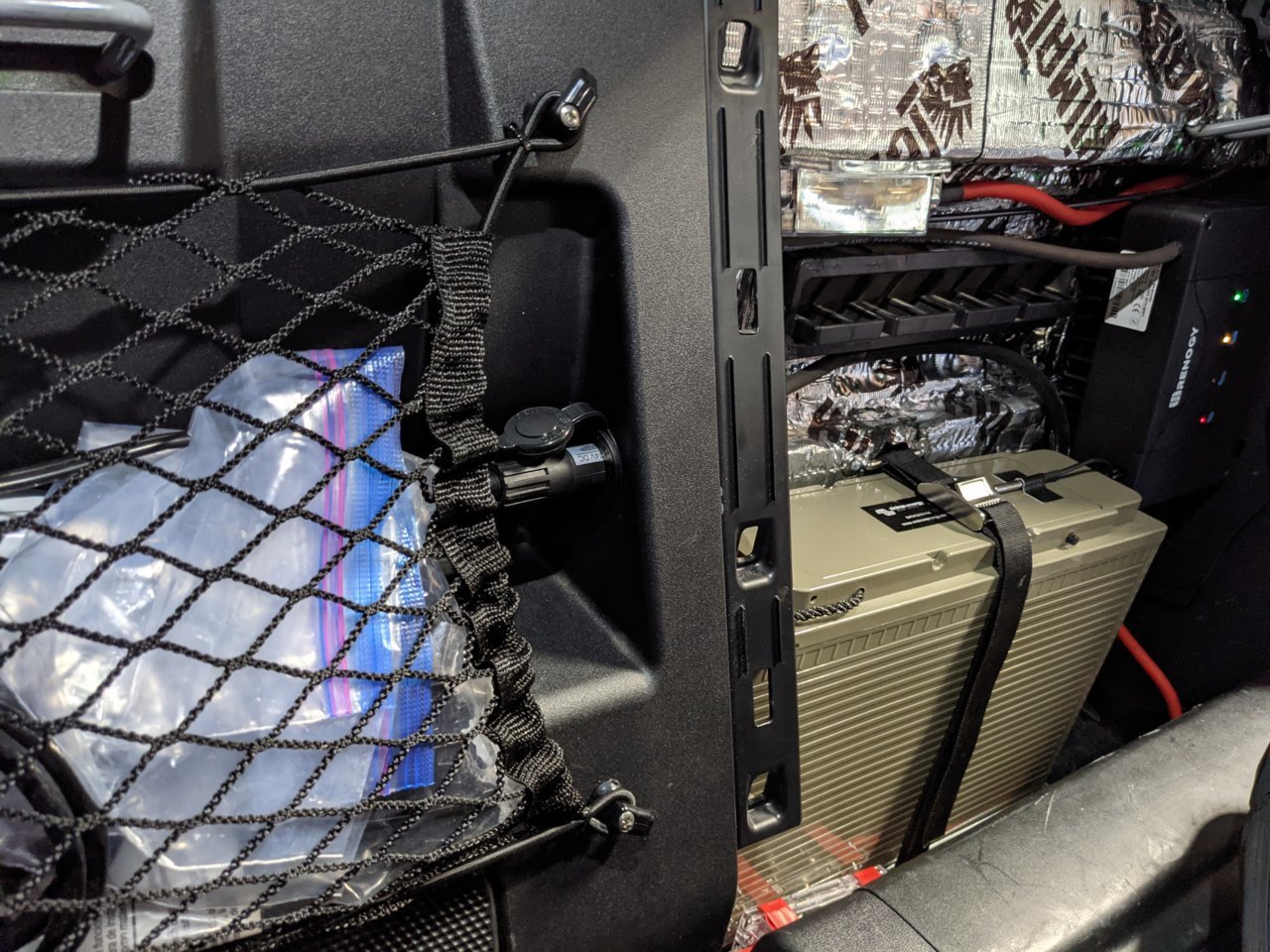

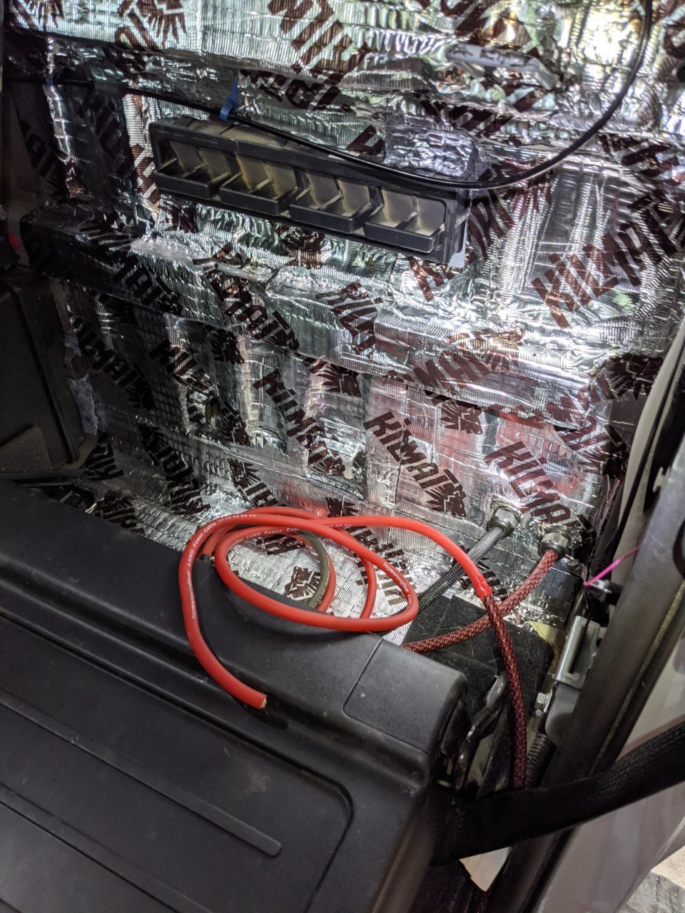

    This is my Dual Battery set-up that I recently completed. I think it's a really cool/ unique set-up. The battery is a Victron 115AH AGM, the charge controller is a Renogy DC-DC charge controller with MPPT, and all my major wiring is 4awg and my fuses are 60amp.

    Where did you pick up that Victron battery? 115ah in that footprint is pretty good.
    gsubioguy likes this.

    I got mine from a friend at Access Power Solutions, but I do believe there is a couple companies out there that can also ship to you. Search Victron 12v115ah AGM, you should see some options.
