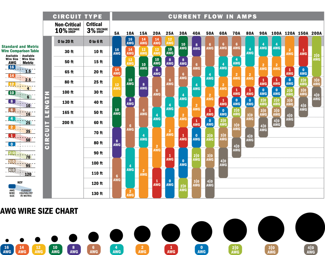

    Ok. What about the 8awg wire going to the house battery? Can i use one of those fuses meant for an audio setup? Or would an ANL fuse work ok?

    I guess I should have asked... What guage wire are you running to your blueseas panel? Ultimately, your fuse should be rated based on the length and guage of the wire + the potential draw. ANL fuse works great, if you are using 10awg or smaller wire, you can use many other fuse types.

    I hadn't gotten that far yet. But i have on hand 8 and 16. The blue seas will be less than 12" away from the second battery, like it is now. I have some junky battery cables going to it currently.

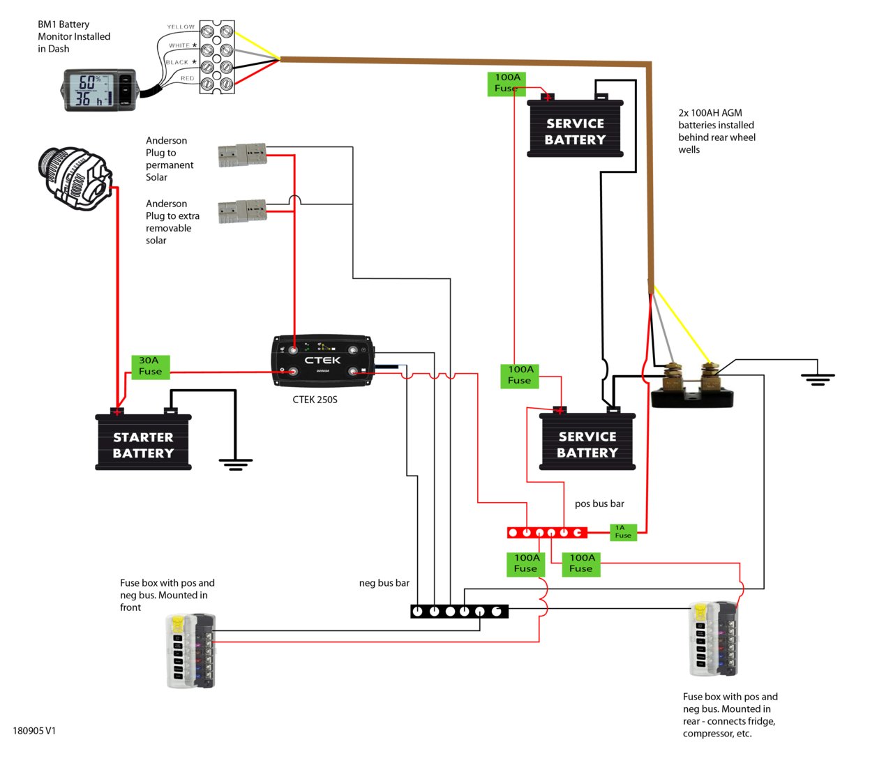

    Hmm i have a CTEK and was wondering if they were similar. Im going to put a 60a between the second battery and my blue seas fuse panel. According to this picture a 30a will work also. The CTEK is a 20a charger.

    Hope your compressor is 30A or less, that’s the max single circuit limit for Blue Seas panels. Otherwise just go with a stand alone fuse or breaker for that circuit.

    Im not following that exactly. My ARB dual is connected through my sPod in the engine bay.
    What compressor are you asking about?

    I guess i didnt read close enough. Its all right here.. ill order up a 30A anl fuse

    The one in the schematic where it says “mounted in rear- connects fridge, compressor, etc.”
    If yours is different then my post is more of a “to whom it may concern” regarding that part of the schematic. Panels have a per circuit max as well as an overall current max. If you don’t mind my asking what is the per circuit max for Spods?
