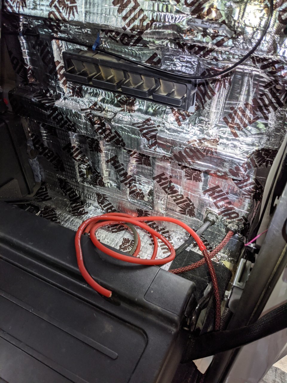

    A question for those of you with a house battery behind the rear seats of a double cab.
    I’m planning on mounting a 100 amp hour lithium and a DC to DC charger behind the drivers side rear seat. I will be running 2 6 gauge wires to the DC-DC and 2 10 gauge to the bed. I haven’t removed the rear seats or back wall trim pieces so I’ve only seen pictures of that area. A quick glance under the truck did not reveal any drain plug knockouts at the back of the cab in that area.
    Is there a factory opening back there that you are using for a wire pass through or are you drilling holes and adding watertight cable glands?
    For a battery tie down strap, is there suitable braces to run the strap under or are you adding footman loops for the strap?
    Thanks.
  7. Jan 18, 2022 at 10:21 AM
    #3247
    BudLoomis
    BudLoomis Well-Known Member
    Feb 22, 2019
    #284015
    124
    Colorado
    2018 TRD Off-road
    Toytec Aluma Series 2.0 (2.5" x 3.5" lift), JBA UCA, Deaver stage 3 Leaf pack, CMC, Viair OBA set-up, KBVOODOO mid rack, Roofnest Condor RTT, CaliRaised Premium Roof Rack w/ 360 lighting, Custom Bed box w/ camp stove built in
    There is one existing grommet you can knock out and I just drilled another hole next to it for my other wire. Also, I used 4awg.

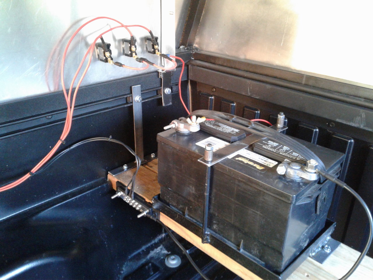

    As many as I can fabricate
    EDIT I just reread this and this is in the bed, not in the bedside. Good luck.
    I used the built in cross steps and the T bolt channel...but I had a cap on the bed. This was really sturdy. I build SFI race car chassis and I think this would pass. LOL
    Zim

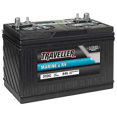

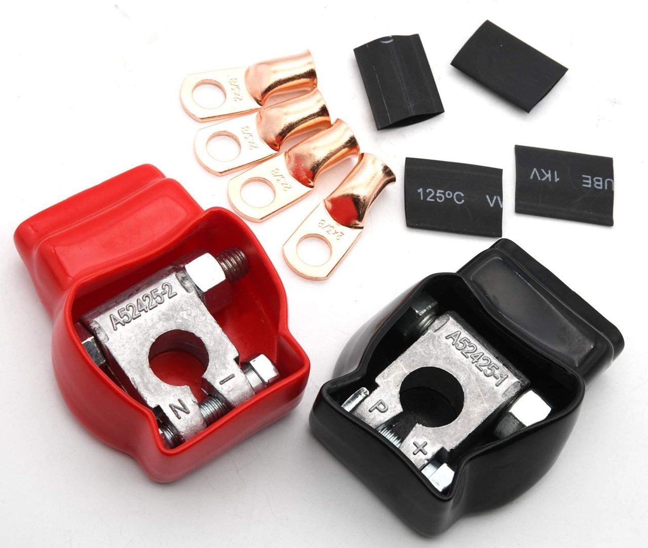

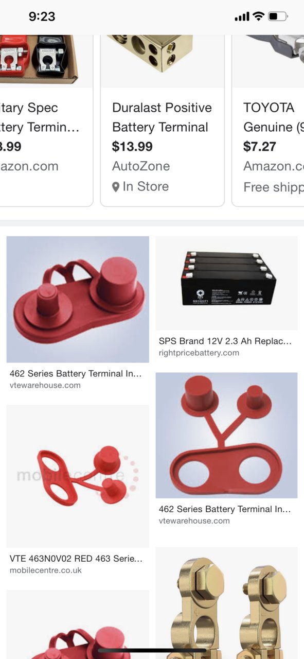

    The same shit everyone else has.
    I’m on the hunt for another elusive part….
    My house battery is a deep cycle battery. I’m using “mil spec” style terminals with cover.
    The battery has the main post and the extra threaded posts like this
    The terminal and covers look like this
    The covers do not cover the threaded posts very well.
    Has anyone found covers that’ll fit the “mil spec” terminals and also cover the threaded posts?
    The closest thing I can come up with is these
    Then keeping the other covers installed as well.
