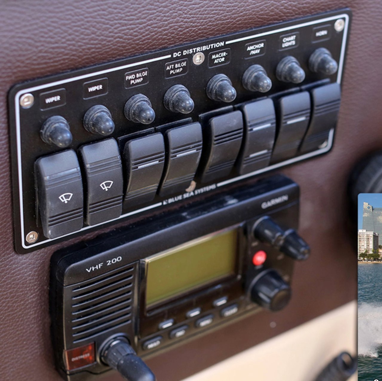

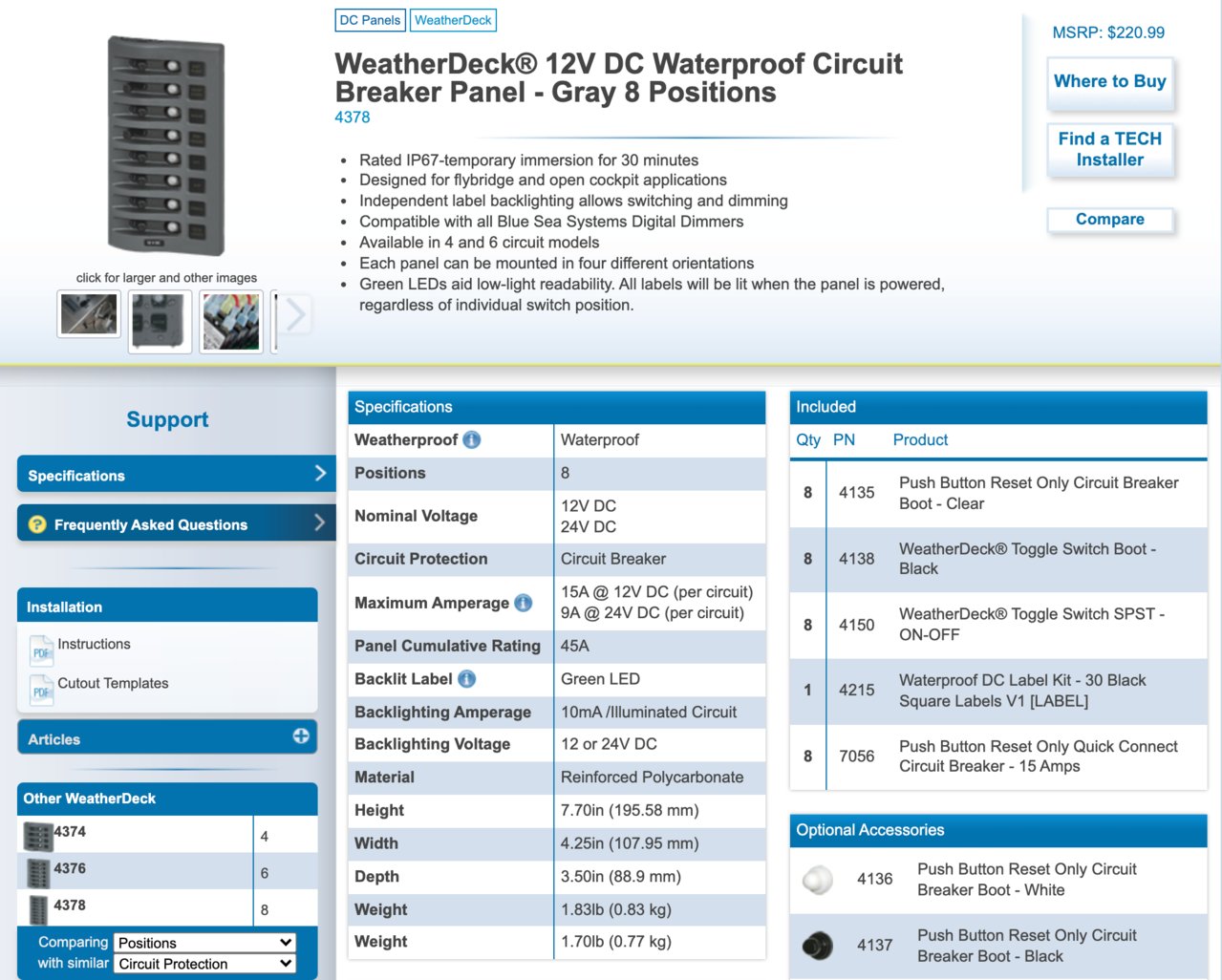

    I haven't decided for sure but I was thinking of something like this Weather Deck unit from Blue Sea systems. I would mount it horizontally in the headliner above the factory center console (I'm not sure if I have the clearance -depth- to mount it in that spot) and would wire each switch to a single pull / single (or double) throw depending on the circuit (oil cooler, Viair dual compressor, or other high amperage circuits) or directly to the switch if I'm powering something with low current draw like LED lights. They are rated to 15A per circuit which should be plenty for my applications.
    • My only concern is the 3.5 inches of depth needed for this application -- in my 3rd Gen when I go past the map lights where the headliner is I can see a flare but I need to get back in there to measure exactly how much clearance there is.
    • Also: I am not keen on cutting the headliner unless the finished product looks stock. I like the weather deck product because it is the same color trim as the headliner center console (or whatever that unit is called). It may be more trouble than it is worth and I may just dremel out factory sized push button or rocker switches in the available space then run a secondary / accessory fuse and relay box in the engine bay.
    Note: I looked at paneltronics breakers as well and it looks like 3.25 - 4 inches is the clearance the panels will need so ya, depth will be the issue in any cab install. Marine applications tend not to be an issue because there is clearance a-plenty behind switch panels / marine dash boards. This may be what prevents me from moving forward with one of these panels.

    I am also considering this style that has the same depth as the product above. I like the look of traditional rockers but if I don't have the clearance in the headliner I don't think I have the space for a panel like this unless I give up the cubby under the center console directly in front of the shifter and dual cup holders.

    If the panel with breakers doesn't pan out I will, most likely go with something like this dude did with a Blue Sea Contura switch panel, factory sized switches, and then an accessory blade style fuse block in the bay.

    That's pretty cool. I don't think you'll have the clearance you need in the headliner, though. Not without designing a frame/case that will smoothly taper between the headliner and the panel. I think there's barely 3 in at the deepest part of the center console area but without measuring, I can't say with certainty.
    What other area would be suitable in the cab? Perhaps between the shifter and a/c controls, where the drinker holders and charger panel are? I am considering putting my switches there with a 3d printed frame.

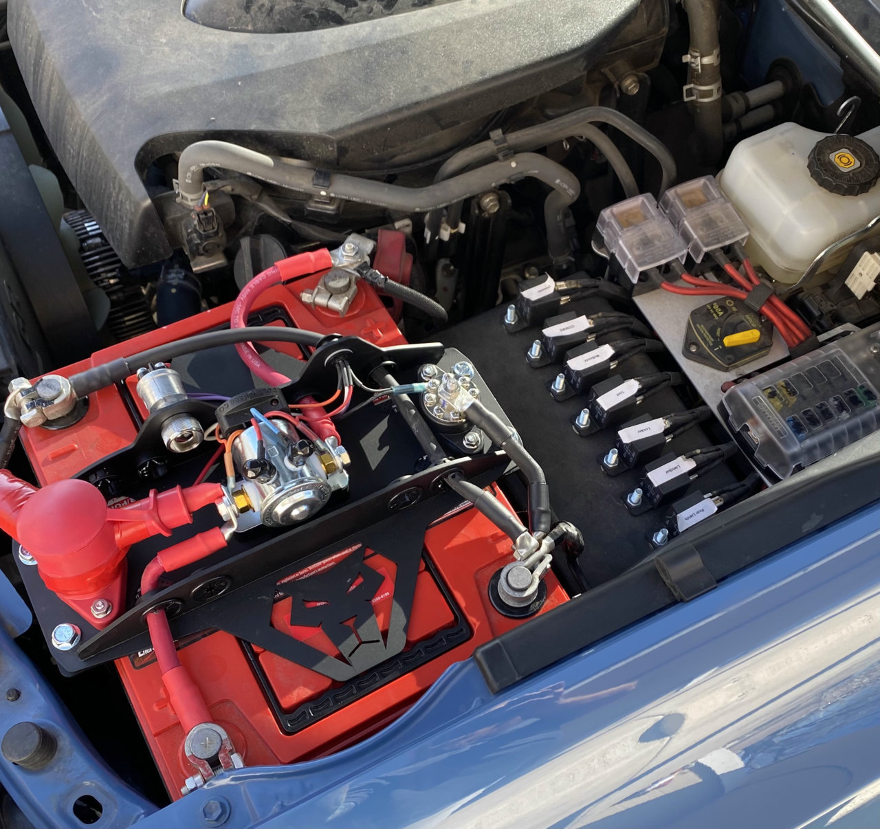

    My setup.

    I will be adding a non-isolated version of the Victron Orion TR Smart 12/12 30A in my truck bed to charge my SOK 100AH LiFePO4 battery. This will be installed on a board next to my MPPT and inverter. Before I do that, there are a few installation questions that I'm hoping you can clarify.
    First of all, do you have the Isolated or Non-Isolated Victron? I ask this because you mentioned only three cables in your setup: two positive cables (in and out), and a negative, so I'm assuming you have the non-isolated version. However, I thought you would only run the negative from your starting battery if you have an isolated system. Please explain.
    I purchased the non-isolated charger because I planned to run the charger negative to the negative busbar (on the board with my MPPT). This will be chassis-grounded to one of the 4 torx bolts holding the bed to the frame. If this is feasible, then when I calculate the cable size for the cable from the starter battery to the charger, the cable length will not have to be doubled in the calculation since there isn't a return cable to the starter battery, correct?
    Finally, do you have a link to the 6 awg "pigtails" that allowed you to insert 4 awg cables into the Victron screw terminals? Thanks in advance for any insights you can give me!

    That is one of the cleanest setups I have seen. My compliments. The only difference I am looking at is a Bluesea ML-ACR to control and isolate the batteries. I like how you mounted the relays. Do you install or do electrical work for a living?

    I do data center work so I’m a sucker for tight cabling, but I learned all my electrical from my Aircraft Mechanic grandfather. That wiring took me a solid 2 days to have ran exactly the way I wanted. The switches even dim with the dash lights.
    Lots and lots of patience.

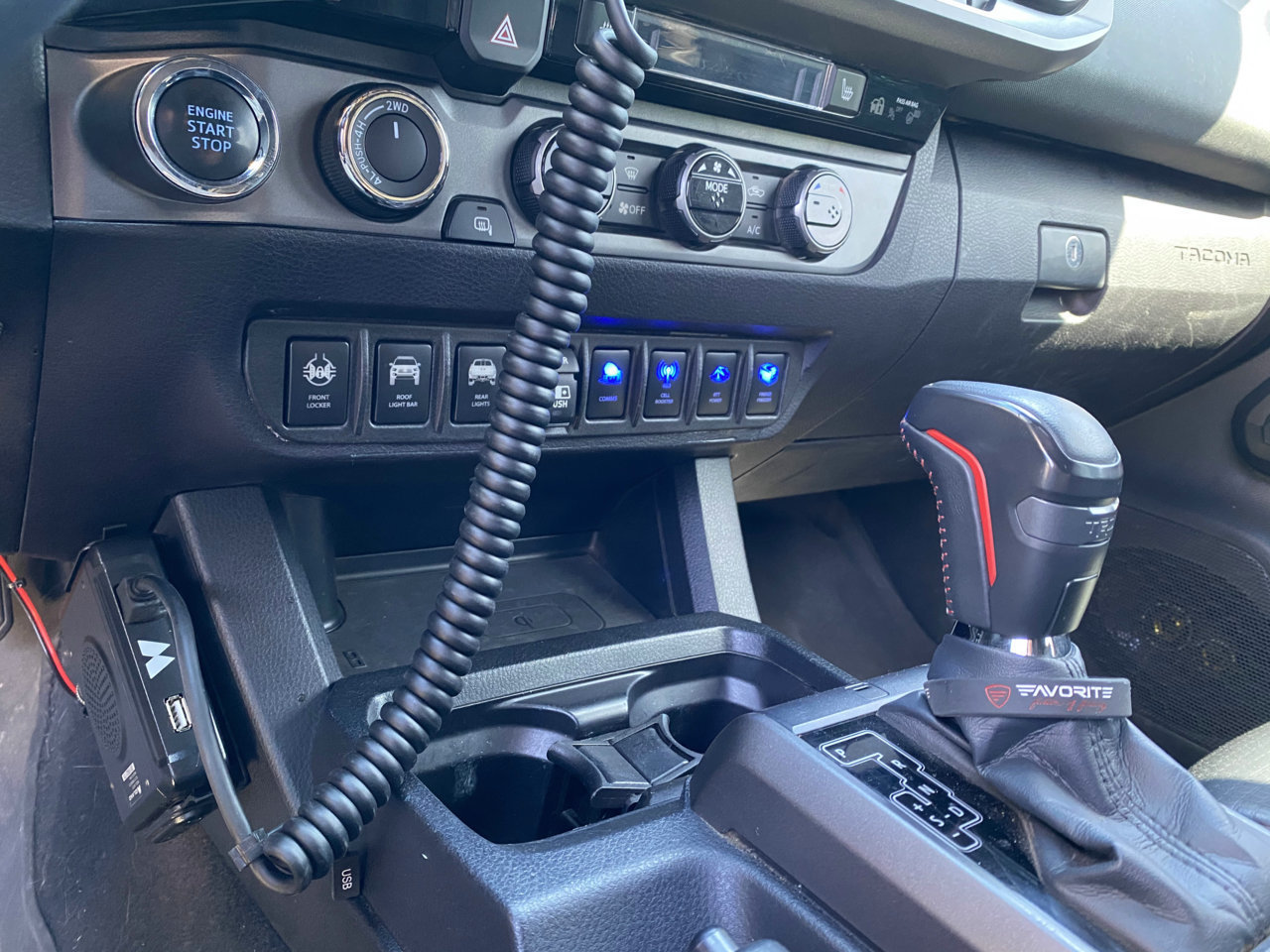

    Ah, but do they dim at the same rate? You usually have to mess with the resistor values for each switch to get them synched for brightness.
