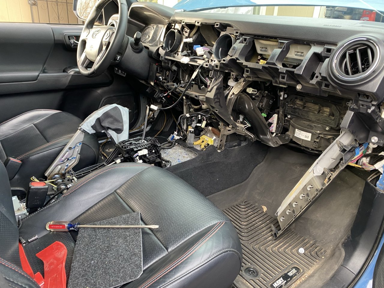

    Not sure but I thought 3rd gens didn’t require as much disassembly as second gens to access behind that part of the dash. On my second gen I did it in conjunction with F/R camera anytime upgrade and though tedious it wasn’t impossibly so. Most of the initial stuff goes quickly both on removal and install. Most of the work I had to do happened before I even touched the truck.

    tbh…. Huge pain in the ass. You have to disassemble the ENTIRE dash and center. Then you have to cut it apart with some finesse and glue the panel on.
    Installed a Kicker Key 200.4 at the same time so that I could have it good and mounted hidden away. Improves the hell out of the audio quality.

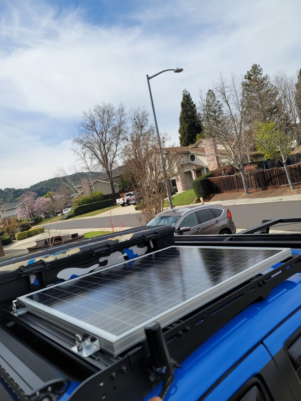

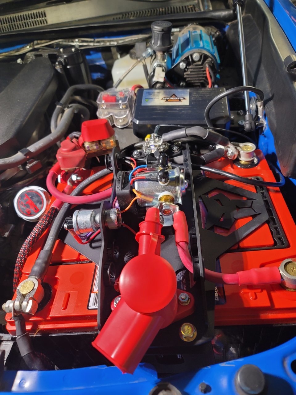

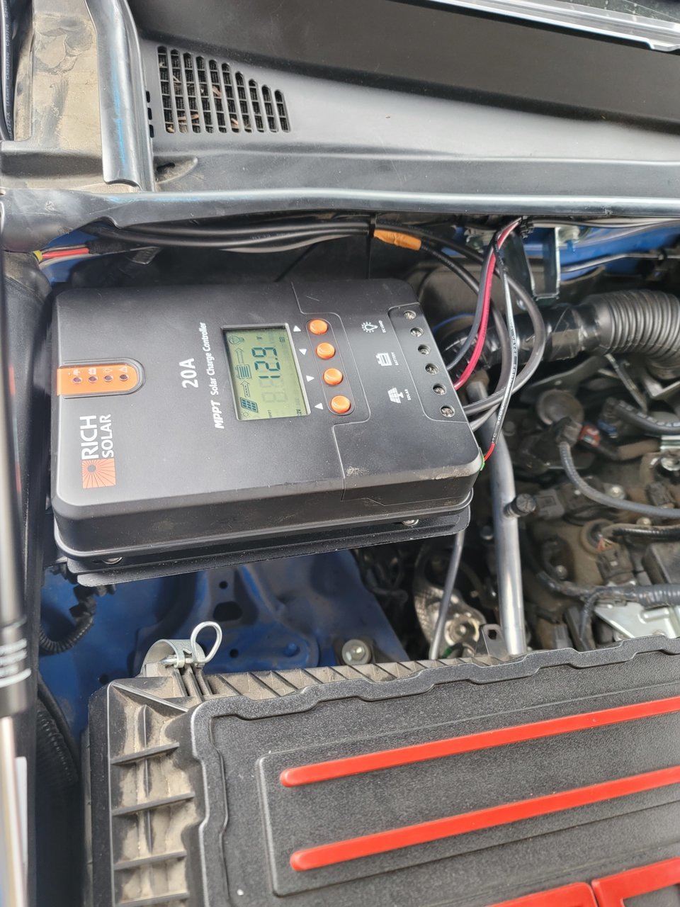

    Installed the genesis kit with group 34 odyssey batteries. Also installed a 100w solar panel with Rich solar control charger. Just enough for a trickle charge out in the middle of nowhere. At home I trickle charge with odyssey charger.
    With all the accessories I'm running in the vehicle, high stereo amps, and when offroad winch when needed (400+ amps), ARB compressor, portable fridge, ecoflow portable battery, and lighting (ditch, bumper, chase, etc.)
    I also re-tuned the alternator (ov tune) to give more juice from 13v to 14.4 running.. Breakers and killswitch are installed in appropriate units..
