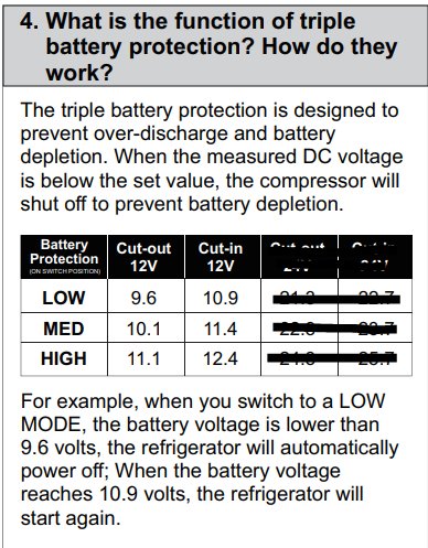

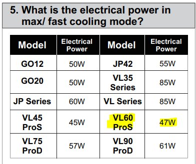

    the max for the Blue Sea 6 fuse panel that I have is 125A. I dont think Im going to run with that.
    The only info I can find for my fridge is:
    0.269kw/h
    Im sure the LED bed lights barely draw anything. I wasnt worried about the wire size. I think Im going to use 8 gauge, as that is what I have on hand. The wire between the breaker and the blue sea is going to be less than 6". I have already sized out between the starting battery and the DCDC charger to be 8 gauge (sized even bigger than they recommend) per the CTEK manual, so Im good there

    The breaker is to prevent wires from burning up or a short from damaging things so make sure you size the breaker for the wires carrying capacity. I would note it somewhere on the fuse panel the breaker capacity so you don't overload it by accident based on what the panel is rated at by adding anything later.
    The breaker/fuses are not supposed to trip all the time, they are an emergency feature. It should be sized to what your wires amp rating is not what your equipment pulls.
    The individual fuses in the panel will protect the equipment
    You should size the wiring based on what your power needs are.
    47watts is 4 amps.
    Figure 1-2 amps per light for smaller led lights (rock lights) and up to 30 or 40 amps if its an off road driving light.

    you were right, 1.10 amps per string, 13.7 watts per string @ 12.65 volts on a fully charged 100 Amp/Hour deep cycle battery for the bed lights.
    But I already have that setup, with no issues. I am adding a DCDC charger and a breaker to my already current setup. I have the wire sizes/upsized for the lenths that I am running.

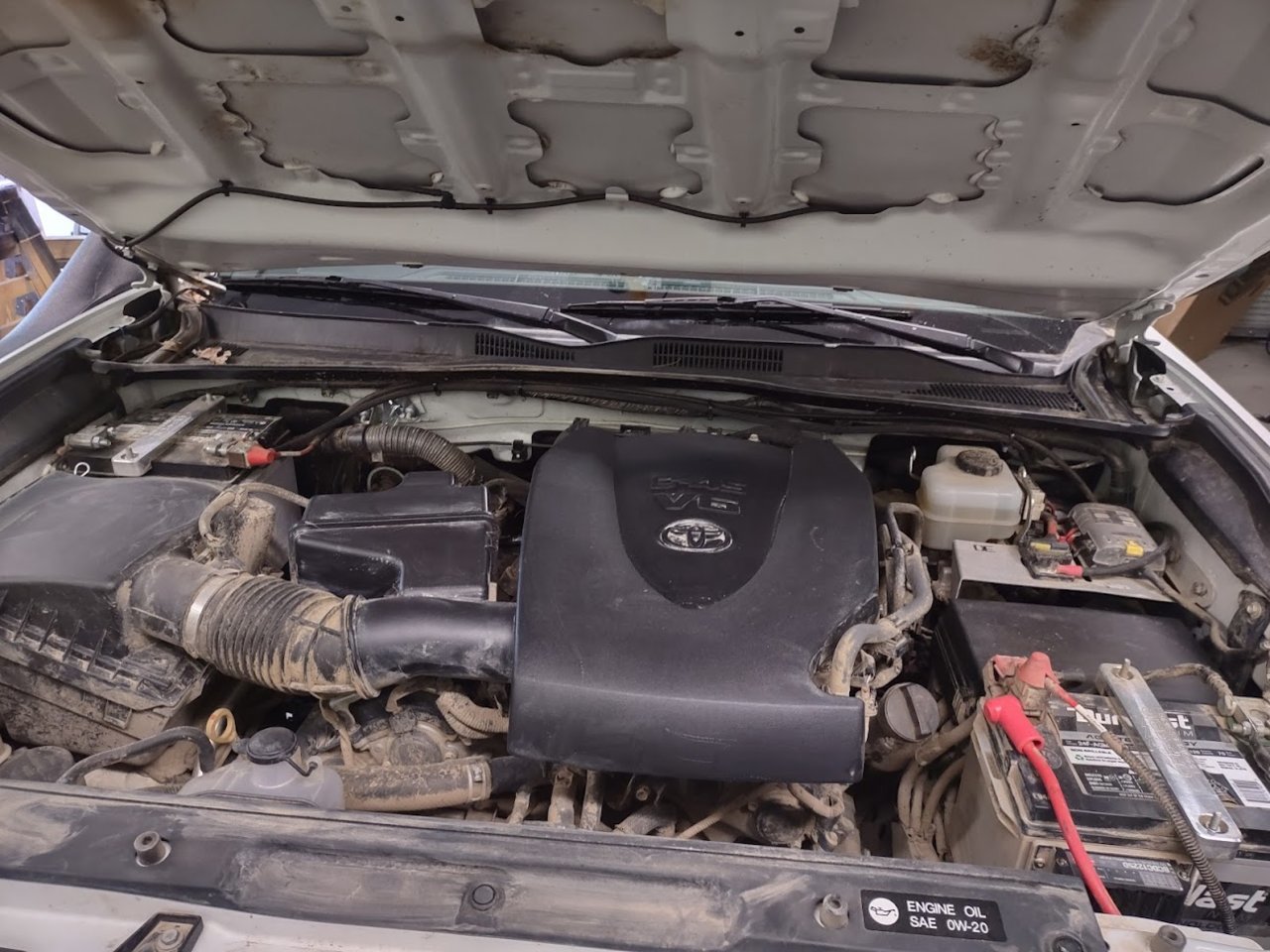

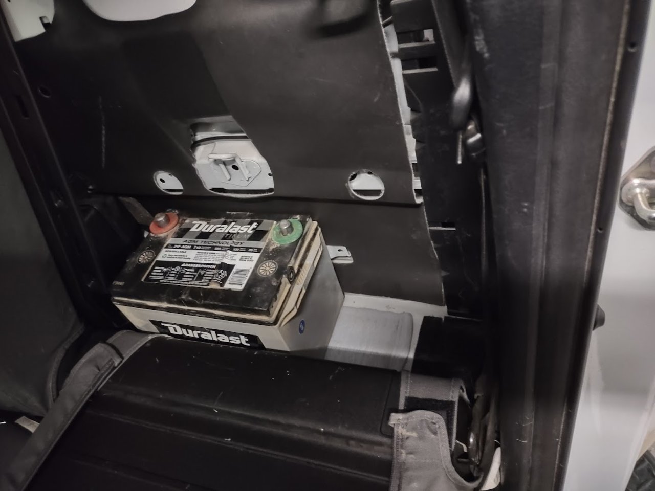

    So I've been using the OGE/Redarc dual battery kit for about two years now, pretty happy with the performance. Unfortunately I recently discovered some big cracks in my DS radiator side support...apparently this isn't a super uncommon issue with trucks that see a lot of off road. Anyhow now I'm pretty set on using my passenger side mounted group 35 for the starter battery and relocating the house battery, BCDC, and fuse panel either behind the back seat (preferable) or under my Alu-Cab canopy (would like to avoid).
    The current group 24f starter battery fits behind the seat fine, but the top of the case got dented by the stock battery tie down years go before I installed the OGE trays. It isn't leaking and that hasn't bothered me too much under the hood, but it's giving me pause moving it inside the cabin like that. I'm kinda waffling between replacing it with another deep cycle AGM or biting the bullet on a LiFePO4 battery. Anybody have any bad experience with LiFePO4 other than a bruised wallet?
