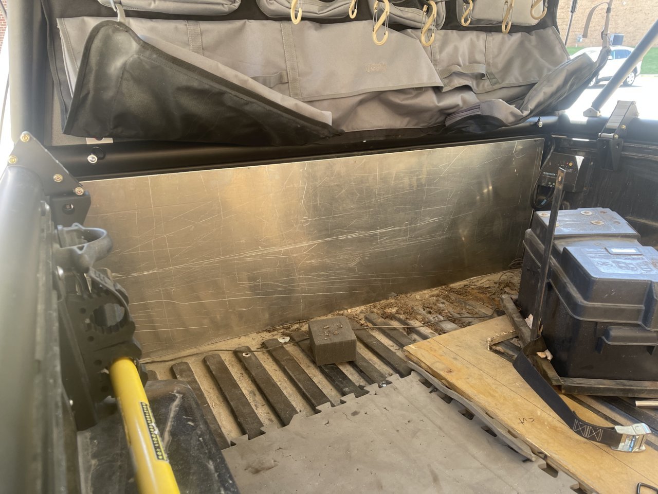

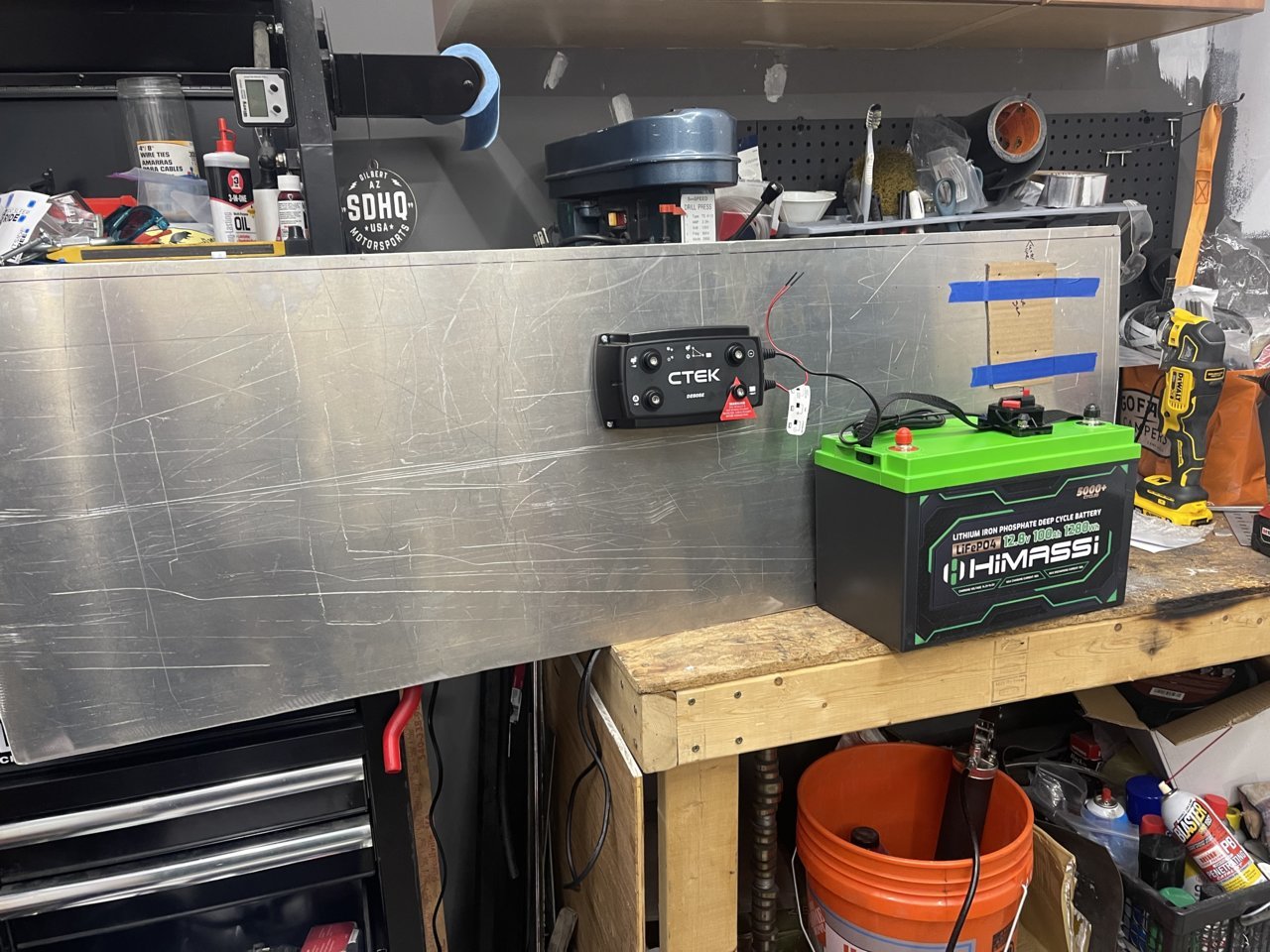

    I bought a piece of 1/8" aluminum to mount everything on. Its not done yet, hopefully soon

    And the surfaces?

    The mounting surfaces, plates, flat areas.

    This is what it will look like. Its not done yet
