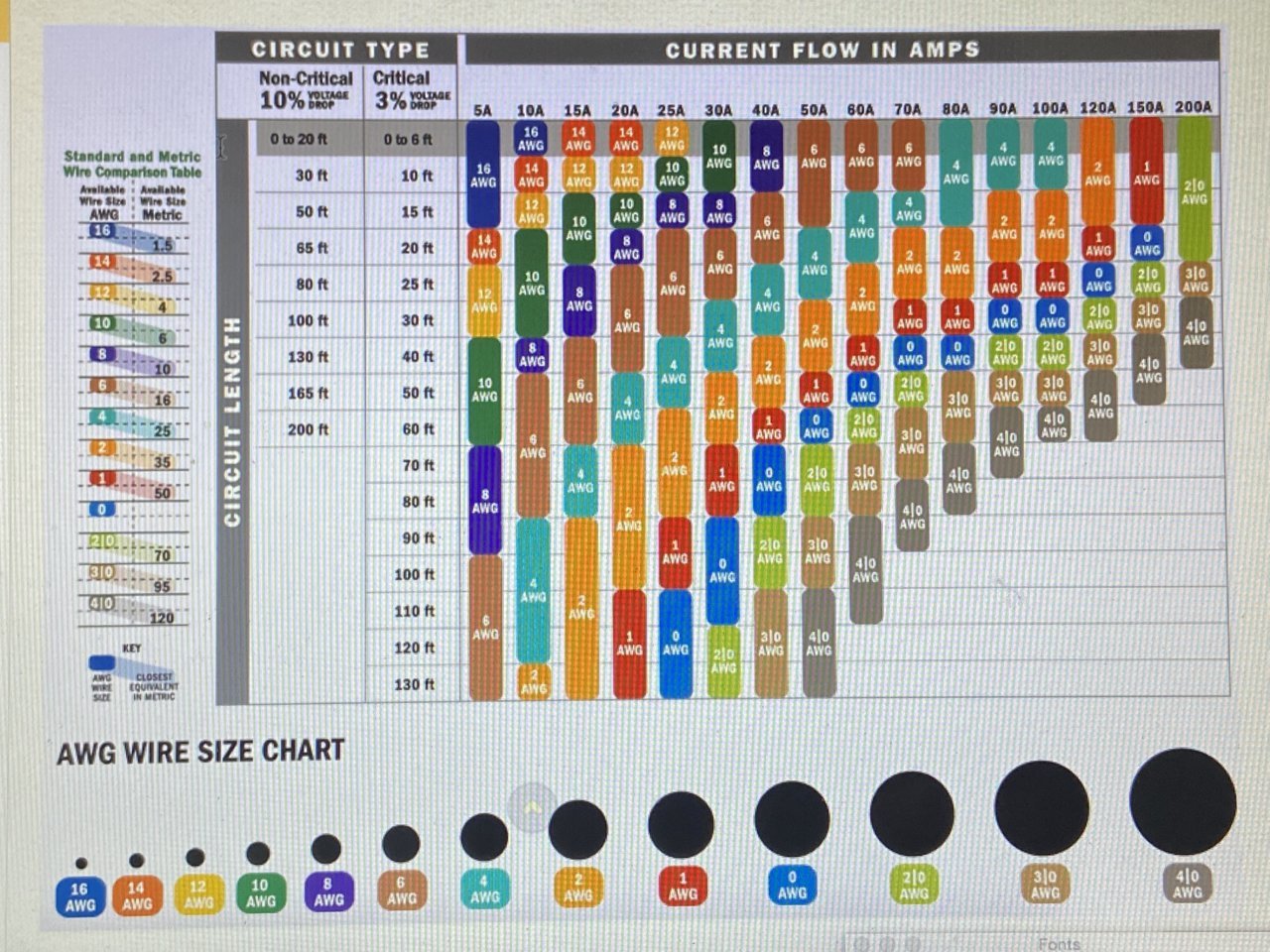

    I am by no means an expert on wiring, but I would be concerned that the 4AWG wire is undersized due to the distance and size of the inverter. This is because 4AWG wire has a rated ampacity of 85 amps at 75°C. A 2500w inverter can draw over 200 amps, so the wire could overheat if it isn't sized appropriately and you are running high loads for long periods of time.
    Another issue is fuse size. If your fuse is sized for 4AWG wire, it may trip too often. Typically, a 250A fuse is recommended with a 2500w inverter.

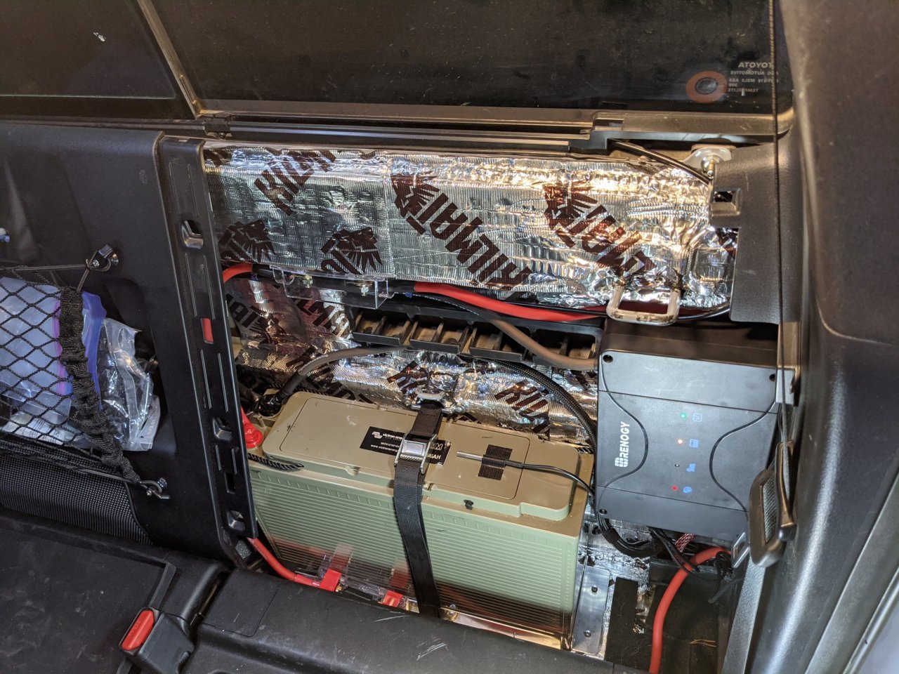

    Thanks, It's a 115ah AGM telecom battery. I use it for my Diesel heater, fridge, tent fan, camp lights, air compressor, and other miscellaneous things.

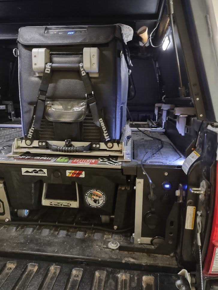

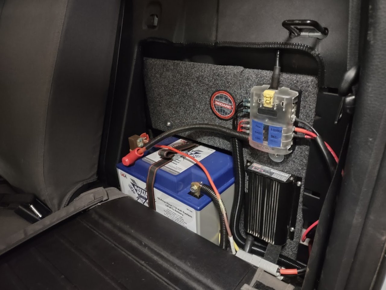

    I was running the OGE dual battery set up under the hood for two years and was fairly happy with it. Unfortunately I'm dealing with a cracked core support from a combination of off roading and the ever popular Energy Suspension polyurethane radiator support bushings...don't do it.
    New set-up has the starting battery relocated to the passenger side OGE tray and all of the house power stuff behind the back seat. I stepped up from a 55 amp hour AGM to a 50 amp hour Battle Born, I hope it's worth the hype. House battery is being charged by a Redarc BCDC 1225D via the alternator and a 100 watt solar panel on my roof rack. The house battery powers a ham radio, GMRS radio, and 2 always hot USB's in the cab. In the bed it feeds the fridge, 2 USB ports, and a total of 5 LED lamps inside he canopy. I also added an extension to the OEM invertor plug to my power panel for shits and giggles, I haven't used it since I bought the truck but you never know. Two big improvements I've made with these changes is I've mitigated some stress off of the core support up front and now none of my aux power wiring is running under the truck.
