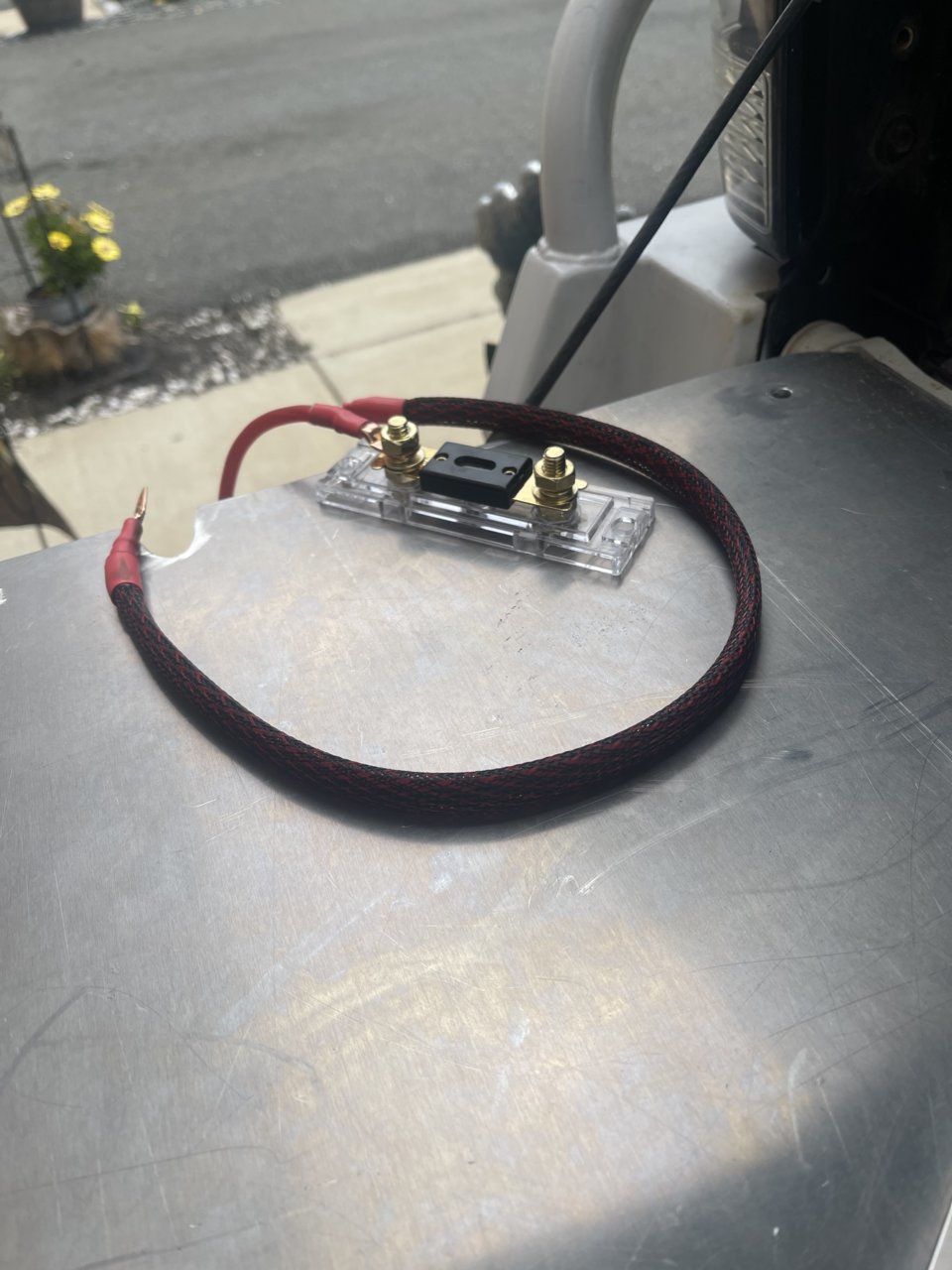

  13. May 14, 2022 at 11:59 AM
    #3473
    fatfurious2
    Jun 28, 2014
    #132884
    49,845
    David
    Ashburn, VA
    2010 TRD OR Access Cab
    Another step done today. Almost ready to mount my bed panel.
    *my sPod is not part of the dual battery setup*
    Greg.Brakes.Tacos likes this.
